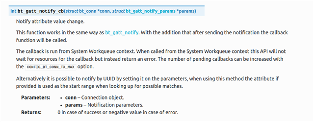

    so I grabbed the thread function they implemented their test in and added it to my code. ran as expected. since I don't want to use a thread, I implemented a work item with the same logic. when using the work item, I receive the error " bt_conn: Unable to allocate TX context" because the transmit buffers are getting full. but when using the thread, this does not happen and the thread blocks til new packet space becomes available. The following is from the post:
    "In this example, the application sends as quick as possible 300 notification packets in a simple loop. What we noticed from the test was that bt_gatt_notify_cb() will not return -ENOMEM when the buffer is full. Instead, the function that requests the notification buffer will wait with K_FOREVER for the buffer to be available. This is different from the legacy Softdevice. In Softdevice, if we queue the notification and receive NRF_ERROR_RESOURCES (buffer full), we will need to wait for the BLE_GATTS_EVT_HVN_TX_COMPLETE to retry again. In nRF Connect SDK, it's a blocking function instead, and we need to keep the data alive until the function is returned. Note that unlike bare-metal applications (e.g nRF5 SDK) blocking function in RTOS won't keep the CPU in a busy loop."
    I can NOT figure out why the same function calls behave differently between the thread and a work item. I also noticed in the work item, the connection parameters are requested but the connection parameter completed isn't completed unless I change the connection parameters by hand on the NRF Connect BLE App. As always, any help would be greatly appreciated.
    Wael
  • Hi Wael,
    bt_gatt_notify_cb() uses the system work queue to run the callback function. This is why it behaves differently if called from the same work queue context. If it hadn't, it could have become stuck waiting for the resource to be freed.
    From the API documentation (link):
    A solution may be to queue up 'CONFIG_BT_CONN_TX_MAX' notification packets, then wait for the callbacks to arrive before queueing up more packets again.
    Vidar
