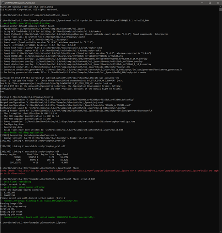

    I am still using the nRF Connect SDK v2.2.99-dev3 but I have managed to build the Blinky sample. the hci_lpuart sample and the LTE Sensor Gateway sample using "west build" command, by ensuring that I type this command in the application's root directory i.e. the folder that contains the application's CMakeLists.txt.
    However, when I tried to flash the "build" into my development kit using "west flash" command (from zephyr build directory) I got the following FATAL ERROR:
    FATAL ERROR: one or more Python dependencies were missing; see the getting started guide for details on how to fix it.
    I did paste a copy of the FATAL ERRORS below (in Italic).
    I checked the getting started guide for details on how to fix this problem but I did not find a clear explanation on how to do that.
    How can this problem be fixed?

    C:\Nordic-2299\v2.2.99-dev3\nrf\samples\bluetooth\hci_lpuart>cd.\build
    C:\Nordic-2299\v2.2.99-dev3\nrf\samples\bluetooth\hci_lpuart\build>west flash
    -- west flash: rebuilding
    ninja: no work to do.
    -- west flash: using runner nrfjprog
    C:\Nordic-2299\v2.2.99-dev3\nrf\samples\bluetooth\hci_lpuart\build>west flash --runner jlink
    -- west flash: using runner jlink

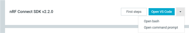

    Can you please retry without navigating to the build folder, and just type west flash in the parent folder.
    Here is the result from opening Command Promt from Toolchain manager
