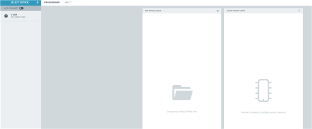

nRF5340 Debug Probe to Nordic Thingy:53 - nRF Connect, nRF Programmer Error: Unsupported device. The detected device could not be recognized as neither JLink device nor Nordic USB device.
I am using Nordic Thingy:53 to build a Matter application using Matter Ecosystem.
Flashing applications via Bluetooth on nRF Programmer mobile application works great.
But flashing via VS Code or via the nRF Programmer in nRF Connect on PC does not work as describe in this https://developer.nordicsemi.com/nRF_Connect_SDK/doc/latest/nrf/working_with_nrf/nrf53/thingy53_gs.html at "Updating through external debug probe"
nRF5340-DK is connected with Data Usb-cable and has also been tested and is working fine. Programs have been flashed on the DK successfully and is working
JLink_V7.66a is installed as required by nRF Programmer and Nordic Thingy:53 is connected via the 2x5 Debug Out connector on the DK as shown in the picture in "Updating through external debug probe" section at the link above.
In nRF Programmer the device shows up as J-Link 001050072180 in the dropdown bar as shown in the image below.
But when connecting to this device (which should be the Thingy:32 through the Debug Probe I recon) I get this error

    As long as both the DK and Thingy are powered and you have the 10 pin cable connected between the debug out port in the upper left corner on the DK and the Thingy, this should work out of the box. Can you double check your HW setup, for instance that you have not plugged the cable on the DK in the Debug in port by a mistake?
    As the next test, can you check with nrfjprog that you read different numbers with this command when the cable is connected (where it should read the DEVICEID from the Thingy and when the cable is disconnected (where it should be the DEVICEID from the DK)?
    nrfjprog --memrd 0x00FF0204 --n 8
    If you read different values, then that means that you are able to debug the Thingy, and we should look more at nRF Connect Programmer. If the values are different or you get an error, then for some reason you are not able to debug via the Debug out port. If the latter is the case, then the first thing I would do is to try another 10 pin cable. They can be quite fragile, and there can easily be a bad connection there even if the cable looks OK.

  • Hey!
    Switching the Power Source to VDD worked!
    I tried to flash the program on VS Code now, and it worked without any issues.

    When you supply via USB the high voltage regulator is used, and the VDD is lower. And you need to have the same VDD voltage on the DK and the Thingy in order to be able to debug it (so that the logical high levels on the SWD lines are the same seen from both devices).
