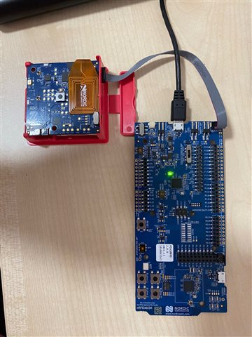

  • Hello, I have a similar problem. I have the same set up:

    This is my connection:

    I run the command: nrfjprog --memrd 0x00FF0204 --n 8 and I got this:
    $ nrfjprog --memrd 0x00FF0204 --n 8 --log
    [error] [ Client] - Encountered error -102: Command connect_to_emu_with_snr executed for 342 milliseconds with result -102
    ERROR: Unable to connect to a debugger.
    [error] [ Worker] - An unknown error.
    ERROR: JLinkARM DLL reported an error. Try again. If error condition
    ERROR: persists, run the same command again with argument --log, contact Nordic
    ERROR: Semiconductor and provide the generated log.log file to them.
    I tried to resert the thingy presing theSW2 and the switching on but I can't see it anymore on the Programmer. Could you help me?
    I don't see any obvious issues with your setup. Can you try to double-check the connections, and perhaps try another 10 pin cable if you have one? Also, if you have another DK or Thingy, see if you are able to debug that using the debug out port of the DK?
