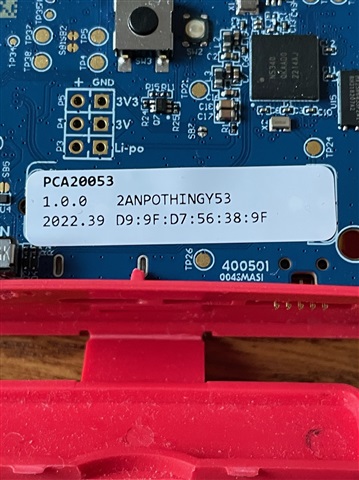

    What is the version of your Thingy:53? You should be able to see this number underneath the NFC tag, right below "PCA20053".

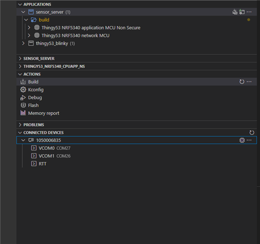

    This is what I see on the list of Connected Devices without the Thingy:53 connected/powered on:

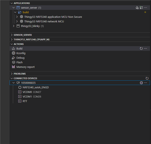

    This is what I get with the Thingy:53 connected via the 10-pin cable and powered on:
    I select the NRF5340_xxAA_ENGD option in the normal way using the mouse pointer and right-clicking.

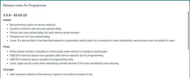

  • Hi Elfving,
    Reading through a similar post, I found a link to this page:
    Getting started with Thingy:53 — nRF Connect SDK 2.3.99 documentation (nordicsemi.com)
    And i note that the latest version of nRF Connect for Desktop Programmer has changes to the USB DFU:
    Should I be using the Programmer application instead to fix the non-working nRF540DK board please? If so, what process should I follow, and can you provide a link to the file to program it with please?
    Al
    No I do not think that would be necessary. In order to program using a DFU the chip in question needs to already have a functioning bootloader etc.

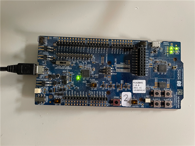

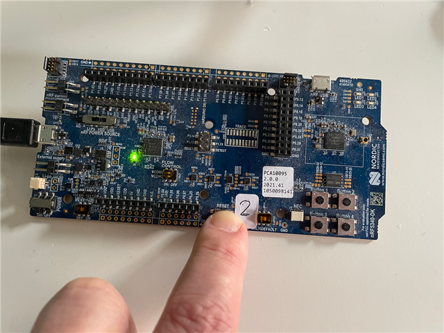

  • Hi Elfving,
    I get the same result (not launching the Bootloader) with the functioning nRF5340DK. JLINK(E:) is launched.
    Photo of reset process on working nRD5340DK:
    LED flashes when there is data communication.
    And then running the already programmed application:
    Incidentally I can use this process to program the Thingy:53 successfully without using the nRF5340DK:
    https://academy.nordicsemi.com/flash-instructions-for-the-thingy53/
    Al
  • Hi Al,
    HĂĄkon is on vacation so I will take over this case.
    It's been a long discussion so I would be appreciate if you can give me a summary of the issue you are having now.
    Please be aware that the method of putting the Dev Kit to BOOTLOADER mode by holding button SW5 when resetting is no longer work with nRF53 DK. On the nRF53 DK it's not possible to manually update the firmware of the interface chip.
    Regarding the instruction you pointed to: https://academy.nordicsemi.com/flash-instructions-for-the-thingy53/ It's about how to use the USB bootloader to program the Thingy53. You will not be able to debug the application on it as you can do with the SWD interface on the nRF53 DK.

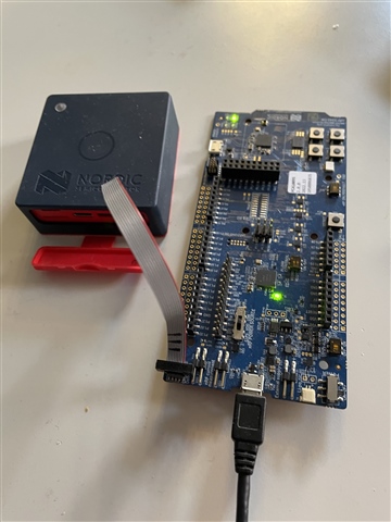

    Also please be aware if you connect the Debug out of the nRF53 DK to the Thingy53 like this:
    You would need to turn on the Thingy to make it work.
    Also in Visual Studio Code you will not see the Thingy name appear but only the serial number of the nRF53 DK.

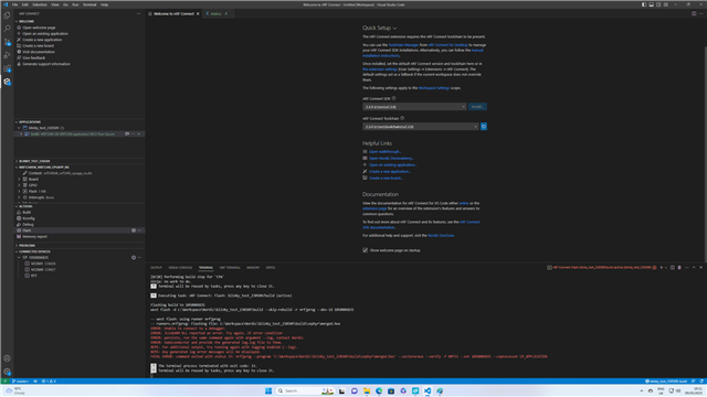

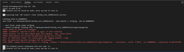

  • Hi Hung Bui,
    As a test, I created a completely new project using the Blinky template. The project builds as expected but then fails when I try to flash it to the nRF5340 DK. I have been previously able to flash this board.
    Al

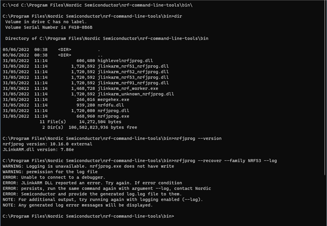

  • Hi Al,
    Is there any chance you know how exact the board stopped working, was it when you did anything ?

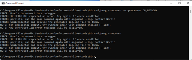

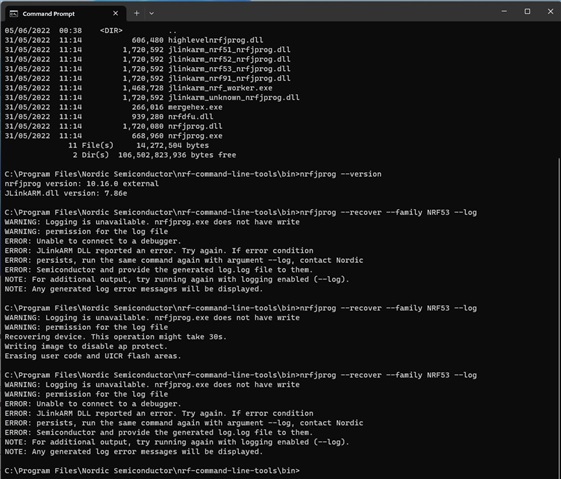

    Could you try the following command:
    nrfjprog --recover --family NRF53 --log
    And send us your log.log file created (in the same folder).
    Also please run this: nrfjprog --version and let us know the version of nrfjprog and Jlink.
  • Hi Hung Bui,
    Unfortunately due to the lack of indication that the Thingy:53 had been programmed in the first place and the resulting confusion with all the multiple attempts to get it working, I can't say when the nRF5340 DK was bricked.
    Results with nrfjprog, it can't create the log file.
    Al
