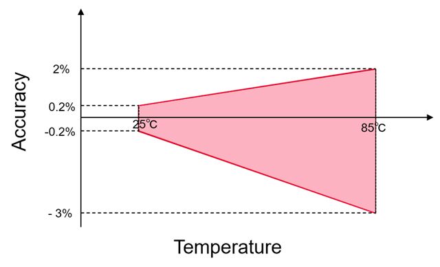

Referring to the following two links, I thought that the error range of the internal reference voltage from 25°C to 85°C is roughly as shown in the figure below, but is it correct?
Correct, this is how it will be.
