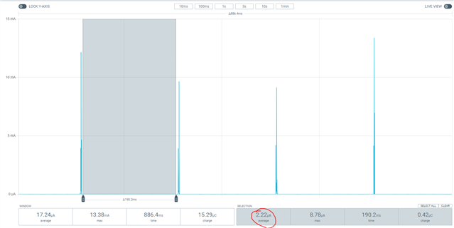

    I think you're mistaken here, as the average current you see in the Power Profiler is 43µA, advertisements included. If you hold shift+ left click to drag you should get a much lower average in between these spikes that will be a better better indication of what the sleep current of your device is. To go into idle mode, I'd recommend using the idle_state_handle() that's used in most of the SDK example projects in the nRF5 SDK.

    I'm sorry about the late reply, but I've been out of office the last couple of days and are only now getting through my backlog. Can you show me what the power consumption between the advertisement spikes are exactly by uploading a screenshot where you have marked the area between spikes with Shitft + Left Click? Alternatively you can export the power profiler trace as a .ppk file so I can review it on my end. Please note that you will need to upload it on DevZone in a .zip file, as the editor on DevZone doesn't support .ppk files.
    The standby current should indeed be able to go down to 5uA or less, but I think the reason it is higher than this is that it's not actually in the a standby mode.

    I am attaching the ppk file of the Power Profile Kit2 you requested.
    Thank you for your reply.
    PPK2_Sleep_Mode_waveform.zip
  • Thank you for explaining and uploading the file. So it seems like we misunderstand each other. You refer to the standby current being the total current when the device is connected and keeps a connection alive, correct? While I mean that the standby current is what the application is drawing in between radio events (the spikes in your power profiling app. Between these, you can see that the average current consumption is ~2µA
    Using the external LF clock will indeed help, as it doesn't make the application wake up every now and then to calibrate the internal RC oscillator. lowering the TX power will also reduce current consumption by a lot as the radio events (spikes) will reduce quite a bit, but this will affect the range and radio performance of your application.
    Increasing the connection interval will increase the time between every radio event so the stretches of ~2µA will be longer and the average lower. I think 5µA while maintaining a connection like this is a bit optimistic, and the 1-2µA average current consumption can only be expected if you have very long sleep times between radio event or if you disconnect from the peripheral entirely and wake up every now and then to connect and do a data transfer. More details on ways to optimize power on nRF52 designs can be found in this guide by my colleague Scott.
