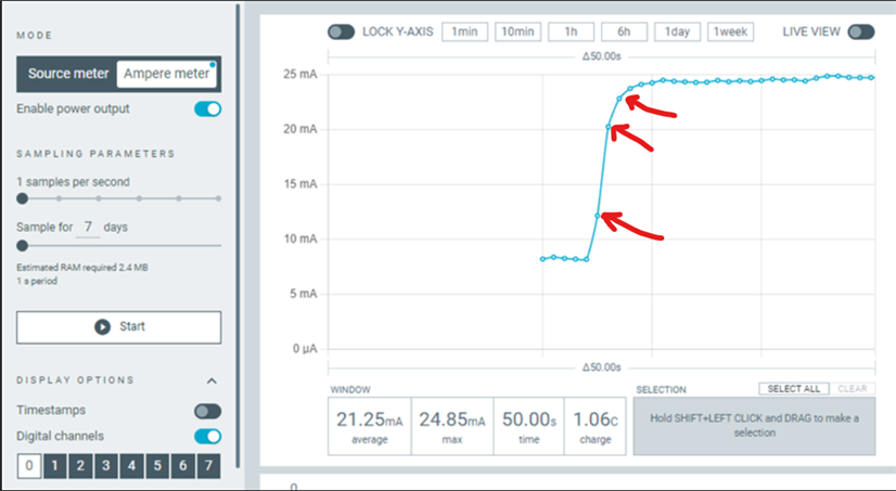

This is the PPK2 measuring at 1 sample per second.
I start up a high-consumption device, which starts basically instantly, and the graph shows multiple seconds of gradual increase.  You can see the individual data points, which should correspond to 1 data point per second.

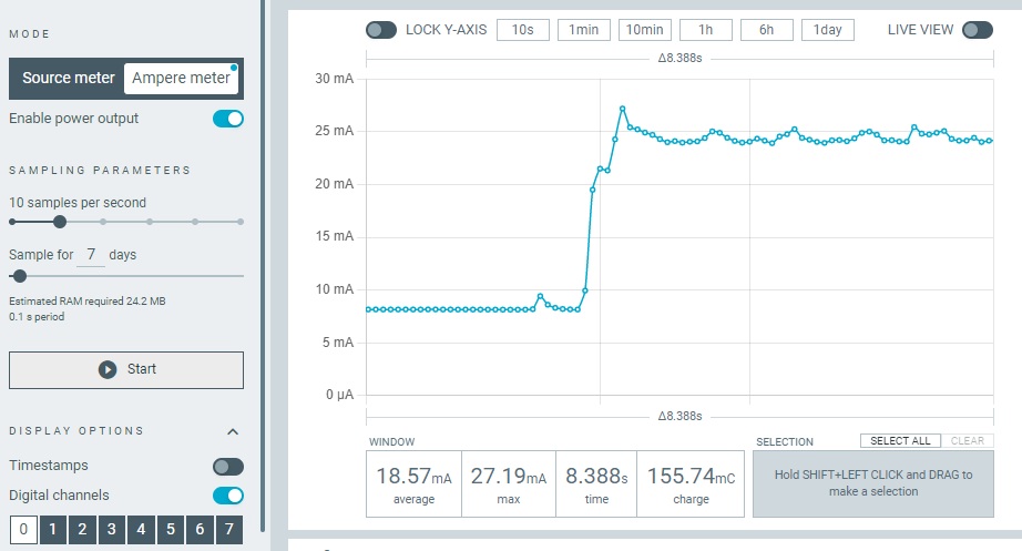

Here is another shot, sampling at 10 samples per second, of the same event.  Now I can see 6 samples leading to peak consumption, which corresponds to 600ms, far less duration than the 1-sample-per-second graph above, for the same event.
This makes me believe the PPK is doing some rolling window averaging of values.  Is that how it works?

    Sorry about the late reply, I got an update from the devs on this yesterday, and we're using Simple Moving Average to calculate the samples on the fly in the Power Profiler: https://github.com/NordicSemiconductor/pc-nrfconnect-ppk/blob/7d175d9da2a43582de82ce370e75b65ea4236d6b/src/actions/deviceActions.ts#L274-L291
    For 1 sample/sec for example, we use Simple Moving Average on 100 000 samples before returning the averaged values, for 10 samples/sec we do it on 10 000 samples, and so on. So the difference could indeed be quite big.

  • Hi Simon, thanks for looking into that!
    Not sure I understand how the described approach leads to the first graph I showed though.
    Here, at 1 sample per second, I see it takes more than 3 seconds for my current measurement to rise from ~8mA to ~25mA.
    However, I know, from a high-speed measurement, that the rise time is less than 1 second.
    So that means, in the 1-sample-per-second graph:
    • the first plotted rise point used some of the rise in its average
    • the second plotted rise point used some of the rise in its average
    • the third plotted rise point used some of the rise in its average
    How can that be?
    If each point takes into consideration 100,000 samples, and the device takes 100,000 samples per second, then each of the plotted points  couldn't have seen the rise in their window.
    Or do the 1-sample-per-second plot points use overlapping data from one another?
