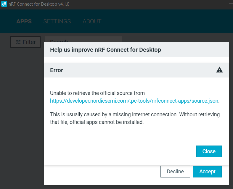

The installation of the nRF Connect for Desktop v4.1.0 is broken due to the network issue.
My company uses the self-signed certificates and uses a proxy with authentication.
It seems that these items trig an network issue during the installation process of the nRF Connect for Desktop v4.1.0
And when I upgrade the nRF Connect for Desktop software from 4.0.1 to 4.1.0 the installation process completes successfully but the Power profiler app doesn't recognize my PPK2 board...
In advance, thank you for your support.

  • Is your colleagues' PC also under your company network? Do you still face the issue?
  • Yes the PC of my colleague is under our company network. And yes the issue occurs again.
