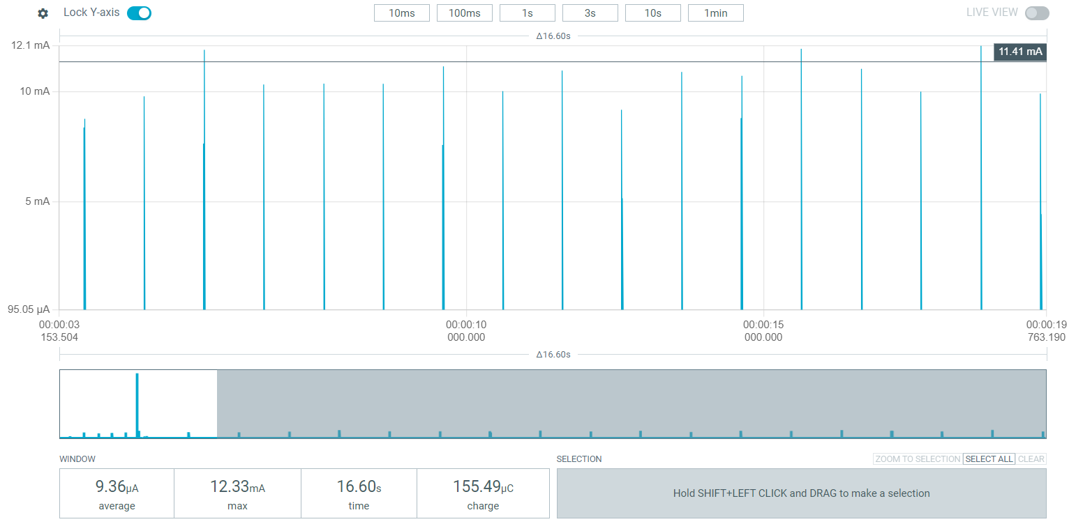

The advertising power profiling was performed with the power profiling sample on the nRF54L15 DK using both nRF Connect SDK with Zephyr RTOS (v3.2.0) and nRF Connect SDK Bare Metal option (v1.0). Below, you will find the results from the power profiling in different advertising scenarios: connectable advertising with 100 ms advertising interval, and non-connectable advertising with 1000 ms advertising interval, in tabular and graphical format. The currents were measured at 3V supply voltage.

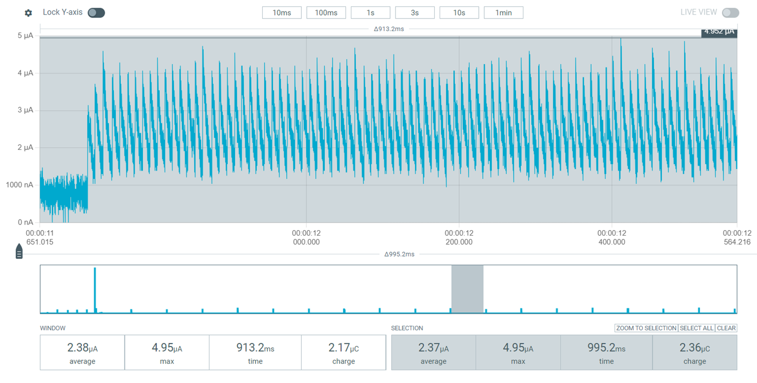

The results also include the idle current that was measured between advertising events with a long (1000 ms) advertising interval to get a stable idle current with minimal effects of current being drawn from the output capacitor, and the total current from a single connectable advertising event.
| Advertising current consumption | Avg. current, 100 ms interval connectable (uA) | Avg. current, 1000 ms interval non-connectable (uA) | Idle current (uA) | Adv. event (mA) |
| nRF Connect SDK Zephyr RTOS | 79.9 | 9.4 | 2.3 | 2.0 |
| nRF Connect SDK Bare Metal option | 77.8 | 10.2 | 2.2 | 2.0 |
nRF Connect SDK with Zephyr RTOS, Peripheral Power Profiling sample, power profiling in Source Meter mode: connectable advertising with 100 ms and non-connectable advertising with 1000 ms advertising intervals. UART was disabled using the Board Configurator app.
Average current (connectable advertising with 100 ms interval): 79.9 uA
Average current (non-connectable advertising with 1000 ms interval): 9.4 uA
Idle current, measured between non-connectable advertising events with 1000 ms interval: 2.3 uA

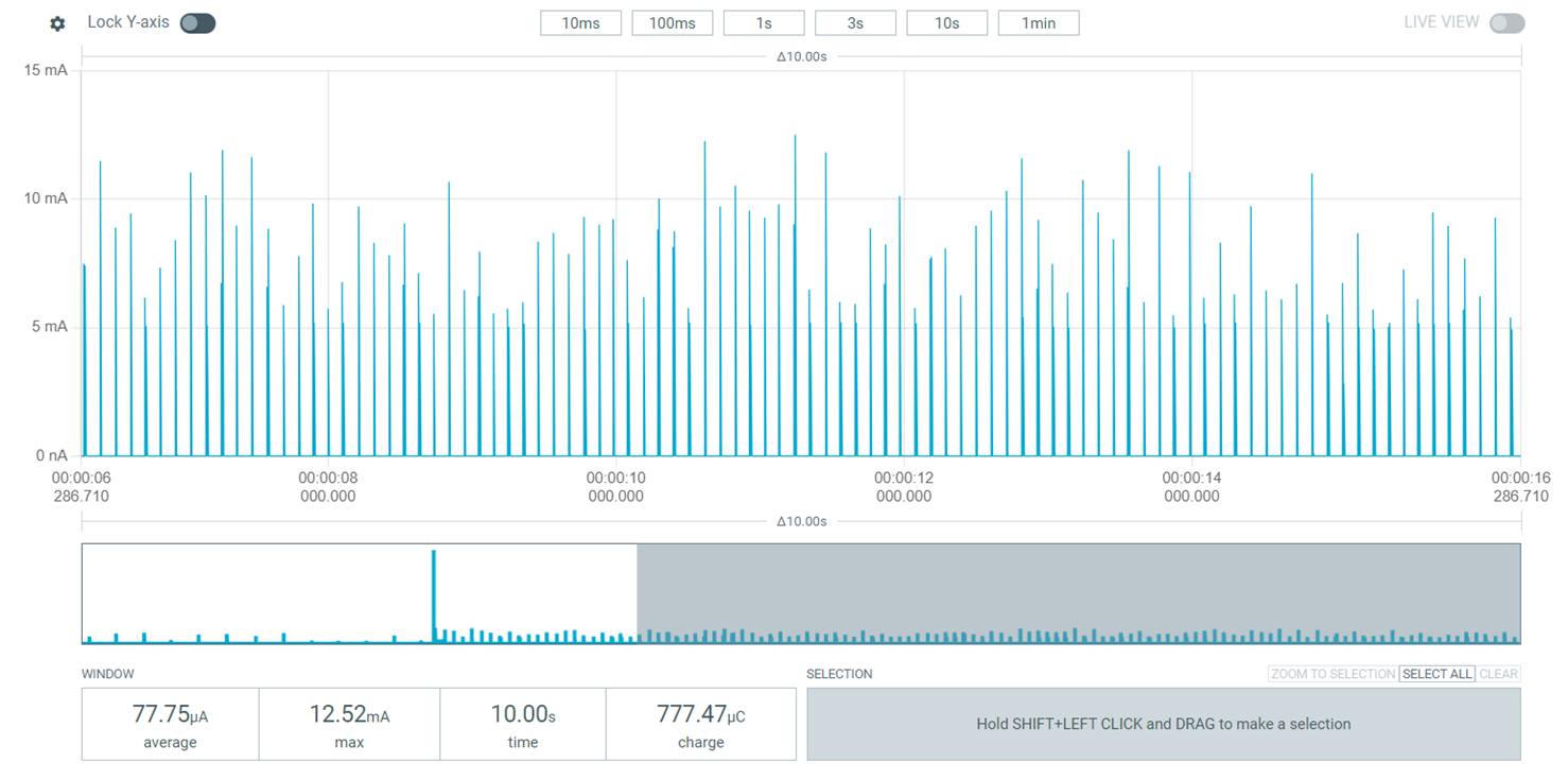

nRF Connect SDK Bare Metal option, Bluetooth LE Power Profiling sample in Source Meter mode: connectable advertising with 100 ms interval and non-connectable advertising with 1000 ms interval. UART was disabled using the Board Configurator app.
Average current (connectable advertising with 100 ms interval): 77.8 uA
Average current (non-connectable advertising with 1000 ms interval): 10.3 uA
Idle current, measured between non-connectable advertising events with 1000 ms interval: 2.2 uA
Connectable advertising event: 2.0 mA

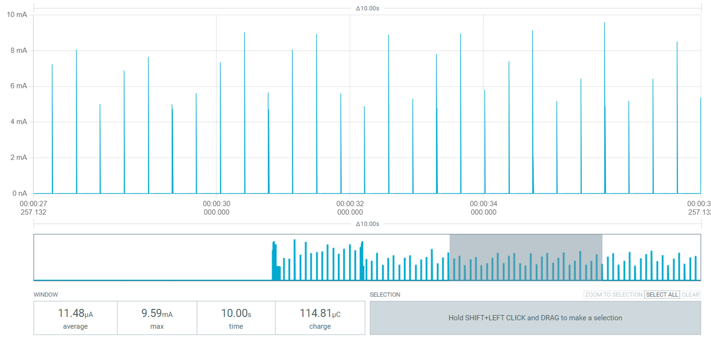

In addition to advertising, connection power profiling was performed with the Power Profiling sample on the nRF54L15 DK using both nRF Connect SDK with Zephyr RTOS and nRF Connect SDK Bare Metal option. Below, you will find the results from the power profiling during a connection with a 360 ms connection interval, in tabular and graphical format.
| Connection current consumption | Avg. current, 360 ms interval (uA) |
| nRF Connect SDK Zephyr RTOS | 11.5 |
| nRF Connect SDK Bare Metal option | 11.5 |
nRF Connect SDK with Zephyr RTOS, Peripheral Power Profiling sample, connection profiling with 360 ms connection interval. UART was disabled using the Board Configurator app.
Average current consumption: 11.5 uA
nRF Connect SDK Bare Metal option, Power Profiling sample, connection profiling with 360 ms connection interval. UART was disabled using the Board Configurator app.
