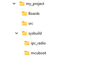

For the prj.conf associated with the ipc_radio, create a folder in your project named sysbuild/ipc_radio.
Your folder structure should look like this:
In the ipc_radio folder create a file and name it prj.conf
Then make the modifications to the file as shown below
CONFIG_LOG=n
CONFIG_SERIAL=n
CONFIG_UART_CONSOLE=n

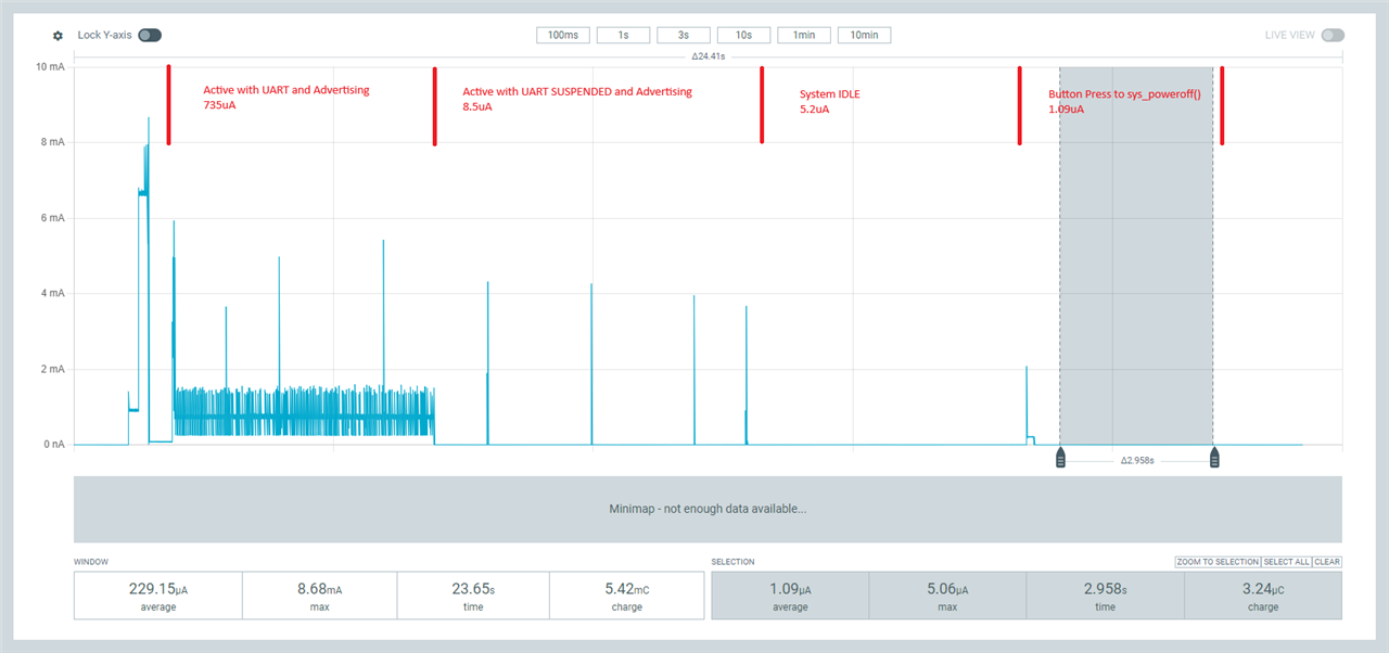

  1. When debugging the nRF5340 you can use thread aware tools like Ozone that will help determine thread status and determine if you are residing in an idle thread.  There is a good tutorial on Thread aware debugging that I recommend to review.
  2. Use the right tool to measure your current. Use the online power profiler and Product Spec numbers to estimate your average current. Use the PPK-2  to measure it.  With the PPK-2 you can log for long periods of time.  Please review this blog for reference.
  3. Make sure to power your design with a battery when measuring current, since a power supply may introduce unknown variables.
  4. Here’s a list of the most common power scenarios and how to recognize them.
    1. You think the part is a PM_DEVICE_ACTION_SUSPEND mode, but the part is drawing much more than 10 uA.The part hasn’t set all peripherals in a DEVICE_ACTION_SUSPEND mode and something has been left running. Make sure your low power procedure actually places all peripherals in a low power state.  It is also recommended that you make sure that the device driver you are using implements the PM API (Nordic Peripheral drivers all Implement the PM API).  While using the PPK-2 you should be able to see the SOC in a low power state and consuming less than 10uA while advertising.
    2. You think you’re in SYSTEM_ON mode with the CPU off but you measure 100’s of uA.You’ve left a peripheral on, maybe intentionally. If you left logging enabled through the UART, this will also use this amount of current. Turn off UART logging in the prj.conf file in favor of RTT. RTT will not use current unless the debugger is connected.
    3. QSPI/External Flash Not in Low Power. If QSPI or external flash is not put into deep power down or is left enabled, it can significantly increase current. Either “disable” the peripheral in the devicetree or use the power management API’s to place it in a SUSPEND mode.
    4. Floating or Undefined GPIOs: Unused or undefined pins can draw current if not properly configured (e.g., left floating). It's best to define unused pins as outputs or enable pull resistors
