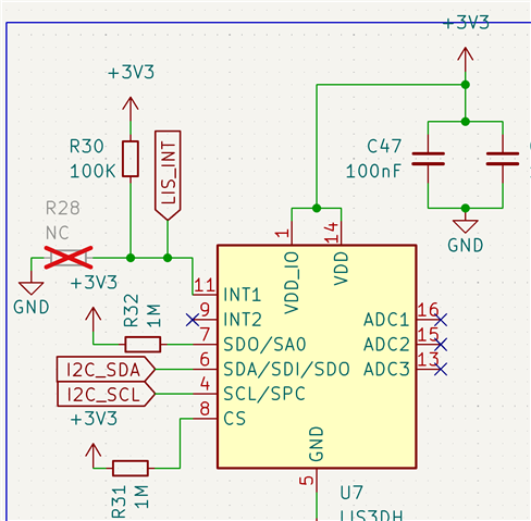

Hi guys,
I'm working on this project which was basically a migration from STM32 to the nordic NRF52832 in order to enable the BLE beaconing mode.
It has been a challenge to make all of the project to run on ZephyrsOS. However, the code is now at a state where all the previous functions are validated and working. I'm now missing the low power consumption mode. This is a battery powered project so the target consumption in idle state should be around 100uA.
Hardware details:

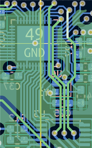

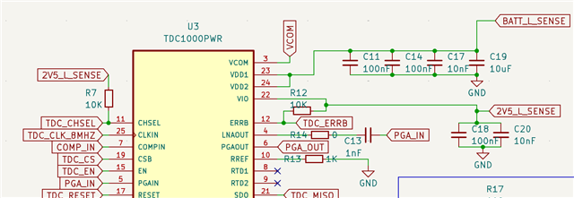

 - Custom PCB
 - LIS3DHTR accelerometer always powered
 - EG915 Quectel with Mosfet for turning it off
 - TDC1000 with Mosfet for turning it off
 - MCP9700Ax-E/TO temperature sensor with Mosfet for turning it off
Requirements:
 - Every 24H run the TDC1000 and MCP9700 and get a sample. Publish the sample using the EG915 and go back to sleep.
 - Use LIS3DHTR to force a sample if high motion detected (interrupt pin), but this can wait.
I've read this article that explains the difference between system_off and system_on and for the NRF52832 I think I don't have other option than going with the system_on. System_off requires external pins to wake up (no timer based option) so it will not work for the 24H requirement. However, as a comparison I've tested the example system_off with my device_tree overlay:

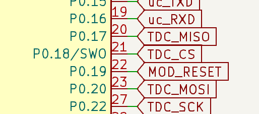

&spi1 {
	status = "okay";
	cs-gpios = <&gpio0 18 GPIO_ACTIVE_LOW>;
	pinctrl-0 = <&spi1_default>;
	pinctrl-1 = <&spi1_sleep>;
	gendev: gendev@0 {
		status = "okay";
		compatible = "vnd,spi-device";
		reg = <0>;
		spi-max-frequency = <1600000>;
		label = "GenDev";

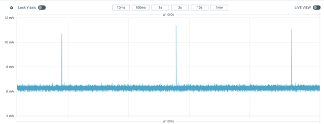

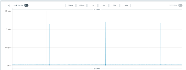

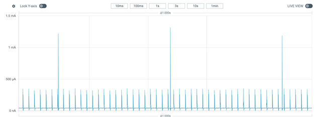

and I got a average consumption of around 40uA.
When I try the system_off in my project it doesn't work and the consumption is around 6mA.

  • Ok, I did some follow up investigation and the problem is not the target board, both nrf52dk_nrf52832.overlay or nrf52kbd_nrf52832.overlay work the same on the system_off example.
    The problem is actually on the proj.conf file. More specifically I did one by one enable until finding the issue and noticed the following:
    CONFIG_SENSOR=y will increase the power consumption from 40.6uA by around 12uA. Later on, when enabling the CONFIG_LIS2DH_ODR_1=y and CONFIG_LIS2DH_OPER_MODE_LOW_POWER=there was a reduction of 6uA. So, I guess this increase is resulting by the sensor callbacks being triggered?
    Anyway, the big issue is the CONFIG_SPI=y. This makes the power consumption to go for the 6mA. I did some investigation and I think the issue has something to do with this line: cs-gpios = <&gpio0 18 GPIO_ACTIVE_LOW>. If I use any other gpio from my debug pins, it works just fine. It goes to sleep mode with the 50uA.
    P0.18 on the nrf52832 is the SWO pin. Maybe, the sleep mode on the SPI puts this pin in some state that conflicts with the SWO definitions? What can I do to fix this? Changing the hardware is not really an option at the moment.
    (No, external pull-ups on the pin).

  • Ok, so I've been playing around with the gpio configuration by calling the gpio_pin_configure_dt() and this was what I got:
    gpio_pin_configure_dt(&cs_gpio, GPIO_INPUT):
    gpio_pin_configure_dt(&cs_gpio,GPIO_OUTPUT_INACTIVE):
    I've measured with the multimeter and oscilloscope and when the P0.18 is configured as GPIO_OUTPUT_INACTIVE the voltage is around 2V and with GPIO_INPUT is 0V. It doesn't make sense for GPIO_OUTPUT_INACTIVE to make the voltage around 2V right?
    CS line is only connecting the MCU and the TDC1000. Nothing else connected on that line.
    I also don't have any clue from where does this 1mA pulses are coming from. At the beginning I thought it was the LIS3D accelerometer, but that are the 400uA. Disabling the accel by setting ODR to 0 gives me this:
     Is the CPU waking up?
    With the following code, I can fix the 6mA issue, since I force the pin to go to input mode before sleeping.
