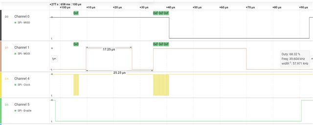

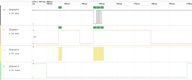

I am using the nrf52840 MCU and NCS v2.6.2 for my application development. Here I am using SPIM3.
I am using a peripheral which have an internal FIFO. From that peripheral, I receive the interrupt when the FIFO is full. I received the interrupt every 160ms and read 360 bytes of data. It uses a fixed register read/write cycle every interrupt for the FIFO read. This process is successful over the longtime. After some random point in time SPI driver sent the wrong value sequence, and due to that, my peripheral internal configuration changed, and it stopped working as per expectations.
  • A successful send sequence of 4 bytes is 0xFF,0xFF,0xFF,0xFF.
  • Found wrong sequence of 4 bytes is 0x00,0xFF,0xFF,0xFF. After this sequence peripheral goes into failure.
If I swap the SPIM2 and SPIM3. The issue is not reproduced, and the peripheral is working fine.
I found the errata document(section 3.29) from nrf web. In that mention, like the tx pointer corruption issue, sometimes, when the CPU accesses the same memory. That causes this issue. I am researching the same, and I found CONFIG_NRF52_ANOMALY_198_WORKAROUND, CONFIG_NRFX_SPIM3 as a part of the solution. This config is already turned on, still I am still facing the same issue.
Can anyone help me with the SPIM3 issue?

  • Let me translate that for your: If you needed SPIM >8MHz, redesign with a newer NRF chip generation.
    The problem is catastrophic, the fix requires a fairly complete understanding how to put buffers into specific RAM locations - which Gnu LD does not like to do at all.
    There cannot be a generic fix because it matters how the SPI data is used later, and because it needs to reserve quite a bit of RAM.
    As mentioned in the ticket, I made 2 different arrays of 8KB each for TX and RX in the .noinit section. But still, it does not solve my issue.

    Can you please check my attached file? Is my understanding correct that I added in the attached file?
    Following is the .map file screenshot for tx and tx buffer used for SPIM with its address.
    Dinkar

  • From the scope traces it looks like you are sending a  single command byte then waiting for a finite time before requesting the response, such as is required for the ADS1299 (ADS1298, ADS1293) recently discussed, A single-byte SPIM3 transfer is known to be problematic, and this could be avoided by issuing a SUSPEND followed by a timed RESUME all triggered by PPI. I'll add a link to the ADS1298/1299 code if I can find it, but meanwhile here's a discussion of the same technique to implement XON/XOFF-style protocol for SPI.
    how-to-do-spim-with-handshakes/514340
    problem-using-the-nrf52840-to-interface-an-ads1298-via-spi
    issue-creating-and-using-binding-files-for-spi
    Edit: To clarify, in case my point was not clear, the point of these links is to transmit a single 4-byte packet (with delay inserted between 1st and 2nd bytes) instead of a 1-byte packet followed by a 3-byte packet; the single 4-byte packet may avoid some known SPIM issues.
