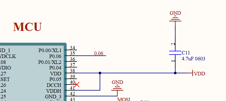

    1. Moreover, in the custom board design, care has been taken in connecting VDD and VDDH together for DC/DC operation. Here are the screenshots from the circuit schematic:

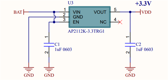

    2. My custom device does not have an explicitly identified VDD pin. I am using an IC test-clip to bring VDD from the output of the voltage regulator to the SWD connector P20. See the schematic here:
    However, this does not help. I still see the same errors on nRF Desktop Programmer application.

    - I have tried providing voltage supply from the nRF5340 dev kit following the guidelines here. I again use the IC test-clip to take the voltage  VDD to the voltage regulator output.
    Is there a fundamental reason why this method would not work?

    The error seems that debug port can not be connected on your custom board. Most likely the insufficient VDD prevent the custom board to access debug port. Have you measured that the voltage is supplied t custom board is as same as DK?
  • Yes, it is the same 3.3 V.
