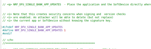

  • Hello Vidar,
    text:
    // <q> NRF_DFU_SINGLE_BANK_APP_UPDATES  - Place the application and the SoftDevice directly where they are supposed to be.
    // <i> Note that this creates security concerns when signing and  version checks
    // <i> are enabled. An attacker will be able to delete (but not replace)
    // <i> the current app or SoftDevice without knowing the signature key.
    #ifndef NRF_DFU_SINGLE_BANK_APP_UPDATES
    #define NRF_DFU_SINGLE_BANK_APP_UPDATES 1

    1. Security concern confirmation: Can you confirm the actual security risk? Based on my testing, wrongly signed files are rejected immediately - I cannot successfully perform the attack described in the warning.

  • They can initiate the DFU process by reusing the init command from a valid update (an init command signed with your key). They will not be able to update to another firmware, but they can use this to erase the current application.
