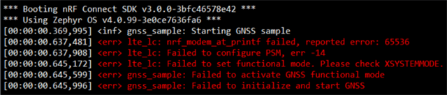

nRF9151 custom board – GNSS sample fails with “Failed to activate GNSS functional mode”
Hi Nordic Team,
I have developed a custom board using the nRF9151 controller.
I am testing the GNSS sample from nRF Connect SDK v3.0.0.
When I flash and run the firmware, I see the following output in RTT Viewer:

    How can I solve this issue?

    I have tested unmodified sample on nrf9151-dk and I could not replicate reported error.
    Which version of the modem firmware do you use on your custom board?
    Sample Used: nrf/samples/nrf9160/gnss
    The GNSS sample is located in nrf\samples\cellular\gnss in NCS v3.0.0.
    Build target: nrf9151dk_nrf9151
    You can try to build the sample for nrf9151dk/nrf9151/ns as specified in GNSS sample documentation.
     Does the error come when building for nrf9151-dk or for custom board?
    Dejan
  • Hi Dejan,
    Sorry for the confusion — I’m actually using the nrf/samples/cellular/gnss example from NCS v3.0.0, not nrf/samples/nrf9160/gnss.
    The build target I used is nrf9151dk_nrf9151 ns.
    There were no errors during build or compilation, and I uploaded the firmware to my custom board using the nRF9151 DK as a programmer.
    After uploading, when I open RTT Viewer, I see the following error:
    Could you please advise on what might be causing this issue?

  • Hi Arun,
    Maybe you have older version of nRF52-dk. Your nrf52-dk should have nrf5340 on it. You could try to program your board using either newer nrf52-dk or for example nrf9151-dk.
    Dejan
  • Hi Dejan,
    When I try to connect my custom board to the NRF52 DK, it connects and I am able to upload code.

    However, when I try to connect my custom board to the NRF9151 DK, it does not connect and shows this error.

    15:14:06.801	Error: Failed with exit code 1. One or more device info tasks failed: * 1051231268: Device error: Setting the debug port SELECT register failed while powering up sys and debug regions (Unknown Error in J-Link DLL (error code =-1)). This might indicate that the debug port is unavailable. Please double-check device power supply and SWD lines, and that SWD isn't disabled (Generic) Message: Operation device-info failed, Device error: Setting the debug port SELECT register failed while powering up sys and debug regions (Unknown Error in J-Link DLL (error code =-1)). This might indicate that the debug port is unavailable. Please double-check device power supply and SWD lines, and that SWD isn't disabled.

  • Hi Arun,
    You could try to recover your device using nrfutil as indicated in this ticket
    You could also try to double-check power supply and inspect SWD lines. Have a look at this thread.
