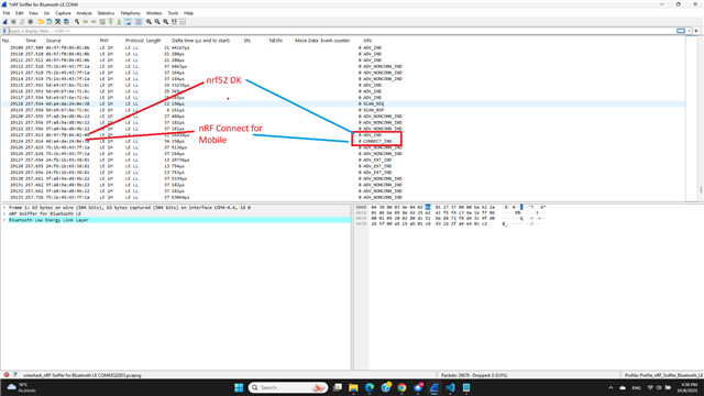

Windows laptop, nRF52 DK (Peripheral), nRF52840 Dongle, Mobile Central (iOS and Android), and Wireshark nRF Sniffer for Bluetooth.
Peripheral sends ADV_IND
Central responds with CONNECT_IND
Wireshark displays the two packets above.
After this, nothing else is displayed.
I tried many times to reconnect by disconnecting the peripheral from the nRF Connect application and initiating the connection again.
Wireshark doesn't display anything related to Peripheral or Central.
I'm not using any filters.

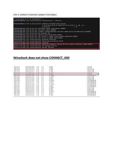

The firmware is working correctly. When nRF Connect Mobile connects to the Peripheral, the VSCode COM Terminal displays:
[00:00:14.671,112] <inf> Lesson3_Exercise2: Connection parameters updated: interval 7.50 ms, latency 0 intervals, timeout 5000 ms
[00:00:14.929,260] <inf> Lesson3_Exercise2: Connection parameters updated: interval 48.75 ms, latency 0 intervals, timeout 5000 ms
[00:00:19.350,433] <inf> Lesson3_Exercise2: Connection parameters updated: interval 1000.00 ms, latency 0 intervals, timeout 4000 ms
But these packets aren't displayed in Wireshark, nor are any other packets.

    After CONNECT_IND, there are no more packets displayed in the Sniffer, but the messages are displayed in the Terminal.
    So the firmware and the nRF Connect for Mobile work correctly.

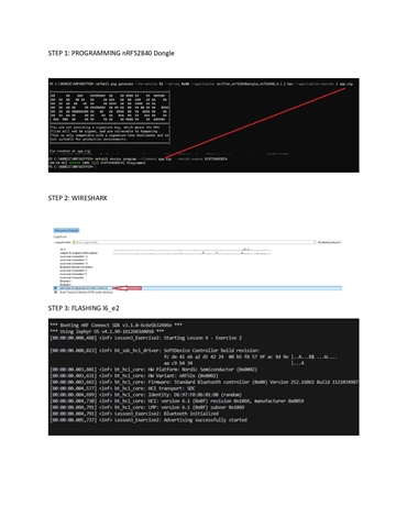

    What you’ve done so far is correct, but you’re programming the wrong file. For the dongle, you need to use the .zip file (see my screenshot below). This is because of the dongle’s bootloader, you can’t use a .hex file in this case.
    When programming the firmware, make sure to provide the full path to where the firmware is located. See the command I used to program my nRF52840 DK (I don’t have the dongle at the moment).
    If you’re unsure where the firmware is located, run the command from the folder where nrfutil is installed and then follow the path to
    share\nrfutil-ble-sniffer\firmware.
    Also, when working with the dongle, make sure to put it into bootloader mode before programming, and reset it once programming is complete.
