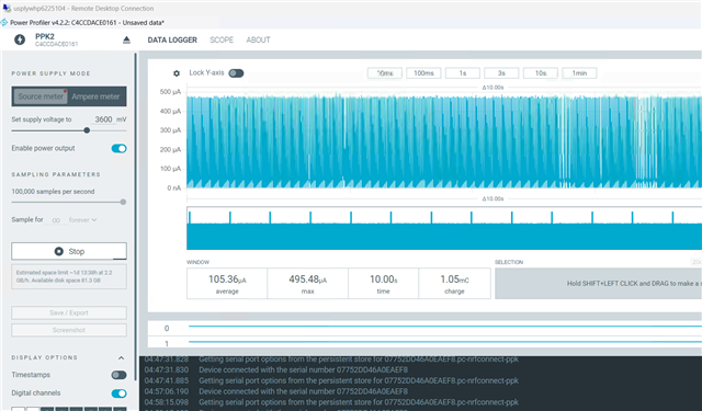

  • After enabling eDRX, we can see a clear difference in the current waveform pattern
  • The RF spike frequency is reduced, and the device is clearly entering reduced power mode
  • So functionally, eDRX appears to be working
However:
  • The average current consumption remains almost the same
  • Measured current is approximately ~110 µA
    • Before enabling eDRX
  • No noticeable reduction in average power consumption is observed

    You are not seeing a lot of difference because you keep your eDRX paging interval very short (~10sec). You are still in ranges supported by normal NB-IoT iDRX (which is used by default). If you want to have a significant power consumption reduction, you can try to make the paging interval longer.
    PSM combined with eDRX would allow you to save even more power. As in PSM mode the whole chip can go into deep sleep. But that also costs the chip to "disconnect" from the network. Overall, adding PSM depends on the pageing frequency that you want.
