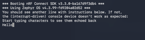

Currently I am working with nRF54LM20 DK. And tried to import and use echo bot example from SDK.
And modified the overlay file as per the UART pin changes required for my application. But I am not able to see any UART prints on console.

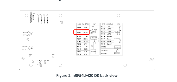

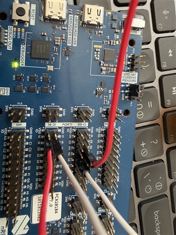

  • Hi Vidar,
    Thank you for your reply.
    Yes because we are using nRF54LM20 DK because we are going to build a custom board using nRF54LM20B. So we have used other pins for different usage. Ok I have tried this and still no output.
