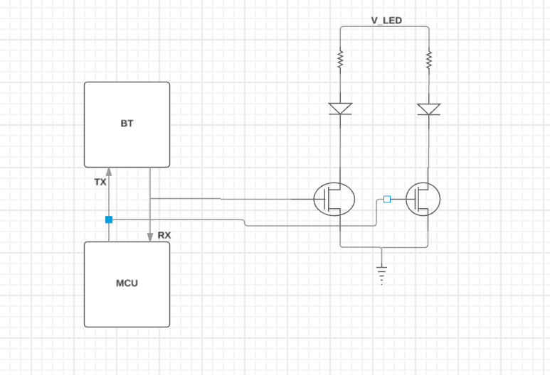

I want to know which pins serve the purpose of TX and RX in nRF51822. I suspect its the ANT1 and ANT2 but i want to confirm and also if the following would be a good way to place status LEDs on the TX and RX lines

Pin functions are described on p12 of the Product Specification (v3.1):
ANT1 RF Differential antenna connection (TX and RX).
ANT2 RF Differential antenna connection (TX and RX).
Note that these are the RF connections - you would not connect these to an MCU!
Presumably, your diagram is intended to indicate a UART connection to the MCU ... ?
when would i use ANT1 or ANT2 ? And does this mean that TX and RX are on the same line so i have to place only when status LED?
As quoted above, these are the antenna connection points.

can you tell me what will happen to the TX and RX for this case? And what is the need of ANT1 and ANT2? I saw the product specification but couldn't understand
Again, ANT1 and ANT2 are the radio antenna - or "aerial" - connection points; so this is where the RF energy is transmitted and received.
It is way beyond the scope of a forum post to describe how radio transmission works!
