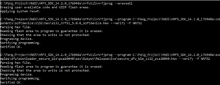

    I test the step and program the softdevices using the following command.
    nrfjprog --program C:\nRF5_SDK_14.2.0_17b948a\components\softdevice\s132\hex\s132_nrf52_5.0.0_softdevice.hex --verify --chiperase -f NRF52
    nrfjprog --program C:\nRF5_SDK_14.2.0_17b948a\examples\dfu\bootloader_secure_ble\pca10040\ses\Output\Release\Exe\secure_dfu_ble_s132_pca10040.hex --verify -f NRF52
    I notice the DfuTarg won't appear if I use nrfjprog to program the bootloader, while the dfutarg works for segger build and run option.

    Thanks for the update. I have check my jlink version. BLE DFUTarg still not working, do you think its caused by segger project compiler setting? I use the default DFUTarg project.
    Here is the programming step
    nrf Connect on my phone with BLE enable, no DFUTarg appear.
  • That's weird. It should work out of the box. Did you generate the hex file that you uploaded (i.e. secure_dfu_ble_s132_pca10040.hex) with segger embedded studio. I tested that file & it worked out of the box.
