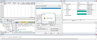

  • Hi HaaKonsh,
    I have to plot SPI_RX Buff value on the Keil5 logic analyzer, but I unable to plot this value may  I know
    Is this a supported function?
    if it is supported then how to read that value?
    I got below errors. please let me know?
    Much Thanks!
  • The digital analyzer tool in Keil is not supported. You'll probably need a j-link Pro in order to use it, but I do not really know how to use that Keil feature.
    I do not know what signal you are sampling with the oscilloscope, but you need to sample all four signals at the same time in order verify correct operation of the SPIM peripheral. You will also need to trigger the sampling from the transition of the chip/slave select signal from high to low, instead of a 'free running' sampling scheme like what you are doing.
