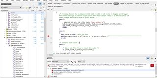

I am working with the Light_switch example of Mesh 3.1 on nRF52832 (PCA10040).
At this moment, I am trying to understand how I can send a message from the server to the client in the network. I found this publication on Github that explains how to create new models for mesh technology. On that page, indicate which functions: access_model_publish () and send_reply () (of the models simple_on_off), is used to send a message from the server to the client as a callback of the client's message.
There is a problem with that. The Simple_on_off models (".c" and ".h" files) are not included in the server and client projects. What I want to know is, if I add (in the main.c code of the server) the function "send_reply ()" (with the correct path, the function and the declaration of the library, etc.), It could works.
In addition, the user of this question modified the simple_on_off_server.c code to create a function called "publish_state2 ()" (I believe that before Mesh 3.1, there is a function called "publish_state ()" but now it is called "simple_on_off_server_status_publish ()", I suppose). I tried to do the same, but when I compile the program, it throws these errors:
Does anyone knows why the code throws those error?

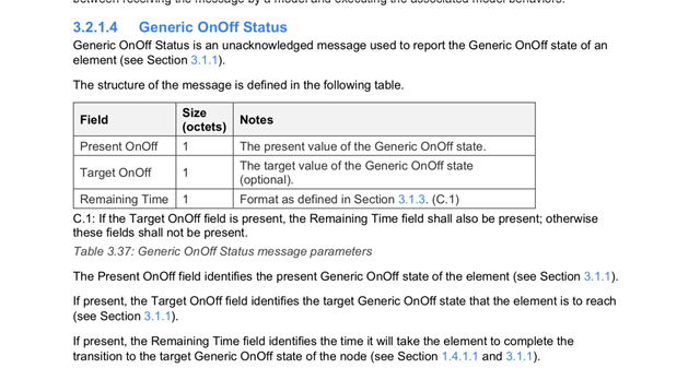

    So, what I thought is, if the server only answers when the clients send a message, I have to understand how I can modify this answer to put-in the status that I want, not the default.

    I don't think modifying the status response is the best way to go as the server model shouldn't be sending new data to the client model. The status should only be the value it received from the client not a new value. I have never attempted to modify the server response as I think this doesn't follow the mesh specification.
