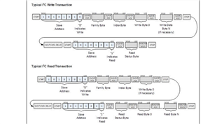

I need to define a I2C communication as a TX of Family Byte,Index and (eventually) Write Byte and a RX of the Status (writing) or Response (reading) Byte. it is a modification of an arduino function that need to return the Status and Response byte depending on the case.

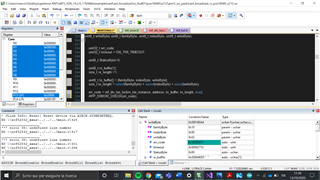

And i have this error both in reading and writing from the second time i use one of this function, so the first READ/WRITE seems to work correctly.

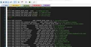

In my nrf_error.h file this error is described as:
Do you have any suggestion about what can cause this error?
    This is fine, as long as every returned error code is passed through an APP_ERROR_CHECK within your function. The important part is that every error code is checked at some point, it is not as important that it happens at a particular place in the code.
    Could you make sure that DEBUG is defined in your preprocessor defines?
    This will ensure that the error message written to your logger contains the exact error, along with the function that returned it.
    Please make sure that DEBUG is defined, and let me know which error code is being generated.

  • Hade Karl!
    Yes i have already set DEBUG in the defines but i am not able to enable the log because of some problems with my sdk_config. I have began the project on the example of ant_broadcast because i ll need to send my data with ANT later.  This is my sdk_config, i have undefined fprintf functions even if i am included all the neccesary src files. Probabily it lacks of some parts of Macros.
    3173.sdk_config.h
    Should i open another ticket in order to resolve before this issue?
    The "err_code" in the pic of the Debug is set at 0x11, it is this the error (NRF_ERROR_INVALID_DATA), correct?

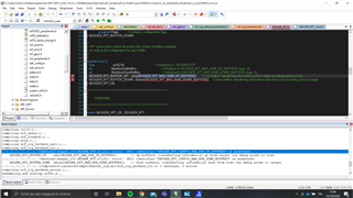

  • Hi Karl!
    I see from your sdk_config that you are not enabling any logger backend - do you intend to use UART logging, or RTT?
    I used PUTTY after enabling the logger but i never see anything, in my config file i was not able to find the UART logger enable as wel as the baud rate selection. I am trying now with the RTT. I have included in the sdk_config.h your script, I have included the sources files of "external>segger_rtt" to my project.
    My initialization function for the log is:
    static void log_init(void)
    The configuration of the RTT is:
    The RTT viewer seems to be connected.
    But i am heading to some errors compiling my code:
    polimarte
  • Hello Polimarte,
    Most examples - except for the ble_app_uart - uses the UART backend for the logger. You could take a look at any of their sdk_config files, to see what you might be missing.
    Please keep in mind that the nRF52832 only has a single UART instance available, so you may not use it for the logger backend if you are also using it in your application.
    You need to add the following source files to your project:
    - SEGGER_RTT.c
    - SEGGER_RTT_printf.c
    - SEGGER_RTT_Syscalls_SES.c
    - nrf_log_backend_rtt.c
    - nrf_log_default_backends.c
    - nrf_log_frontend.c
    - nrf_log_str_formatter.c,
    You could also see this done in the ble_app_uart example, which uses RTT logging.

    Please add these sourcefiles to your project, and make sure that the SEGGER_RTT defines are in your sdk_config.
    Looking forward to resolving this issue together!
    Karl
