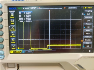

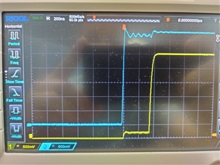

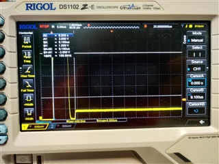

    the problem is only in leading edge delay - there is profit but the problem is still exists. Now the output pin high level differs depending on how it is configured ( nrf_gpio_cfg() or nrf_drv_gpiote_out_init() )
    sdk_config.h
    #define GPIOTE_CONFIG_IRQ_PRIORITY 2
    below best and worst cases

  • I can't get how your signals are put together.. does pulse source have open-drain output?
    At the end of pulse, you call nrf_gpio_pin_clear then configure_txir_pin - between them you have strong low level. You don't need to change pin state, only configuration. For predictable timings, it's probably better to use GPIOTE with NRF_GPIO_PIN_D0H1 output (not sure because I don't know your schematic).
  • Both plots reflect pin state - original pulse ( high one on the plots ) and generated ( low one but not complete ) have delay between leading edges and that is exactly what I was trying to show on plots
    The delay between leading edges ( ~25 us ) is time between GPIOTE edge detect event -> in_handler invocation ->  series of pin commands ( pin_set and pin_cfg ) before nrf_delay_us()
    The strong level you mentioned is caused because of delay when pin is not reconfigured to output - both plots describe leading edge ( despite of second one is too low to be high )

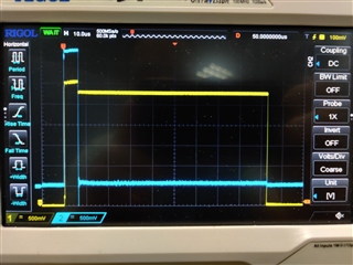

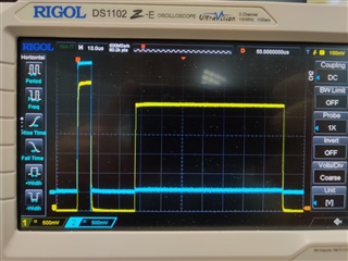

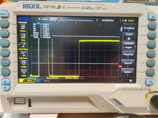

    But I use commented code
    #if( !_PROLONG_WITH_2_PINS)
        configure_txir_pin( false );
        nrf_drv_gpiote_out_set( TXIR_OUT_PIN );
        nrf_delay_us( get_txir_pulse_width_us() );
        configure_txir_pin( true );
    I get next picture with the same schematic but with longer delay between leading edges
  • Yes, there are too much code executed in gpiote library before it calls your event handler. To make things faster, write your own high-priority interrupt handler instead of using library (though with running BLE stack you still get no guarantee that interrupt comes in time). Or you could configute pin as D0H1 and make a pulse with PWM hardware activated by GPIOTE event - I can't say for sure that it will work on the same pin but you can try.
