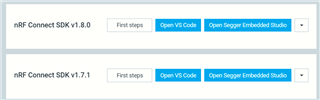

    I have changed the download path to C/ncs disk and E/ncs to avoid a long path, but after trying to redownload the nrf connect SDK v1.7.1  and delete, it still did not work well.
    Most of the time, in a clean folder without anything about nrf connect, after downloading the SDK for the first time, the result is like this:
    And I try to do update SDK and update the toolchain, it goes well with SDK, like what I have downloaded of version v1.6.0:
    But in v1.7.1, as the same problem I mentioned in the main ticket, it could not build a single demo with any board successfully.
