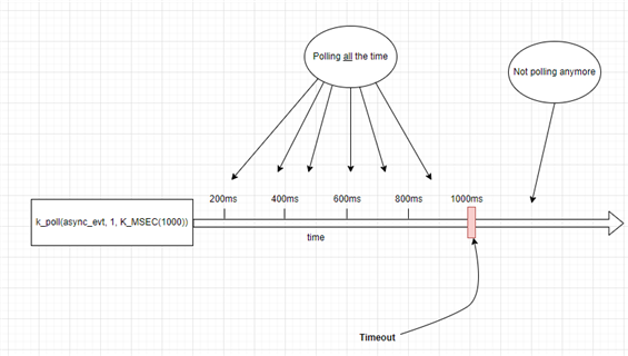

My question is I want to test variations of int num_events & k_timeout_t timeout arguments in k_poll API for "spi_transceive_async".
As in what happens if i vary num_events & what happens if i vary timeout ...?
And how can I get this variation to reflect on "spi_transceive_async"..?
I need to know how to vary and test the sample code at zephyr\tests\drivers\spi\spi_loopback:
