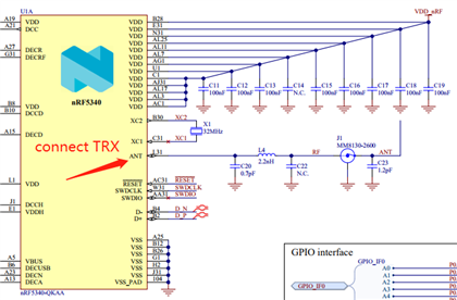

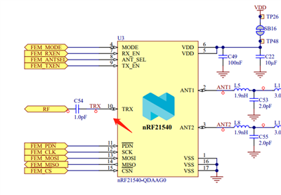

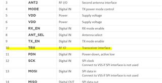

about hardware:  where is TXR connected?   what is its function?
thanks
Best Regards
    about software:    how to create project build?
    See http://developer.nordicsemi.com/nRF_Connect_SDK/doc/latest/nrf/ug_radio_fem.html#programming
    It's for radio input. Since the nrf21540 is more or less just a power amplifier with the option to select between two antennas and adjust the power output. So the TRX pin is the radio in, so if we are to use the nrf52840 as an example it will be ANT pin on 52840 -> TRX on 21540
    See https://infocenter.nordicsemi.com/topic/ps_nrf21540/chapters/hw_layout/pin/doc/frontpage.html?cp=7_0_0_8_0

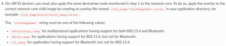

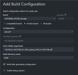

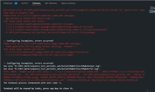

    Extra CMake arguments:
    -DSHIELD=nrf21540_ek -Dmultiprotocol_rpmsg_SHIELD=nrf21540_ek

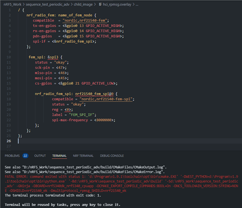

    but i'm failed,   and the link not say how to  change tx_power/selet ant/enable tx_en  by sources code.
    can you fix the project?

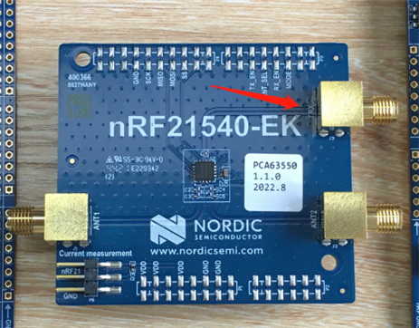

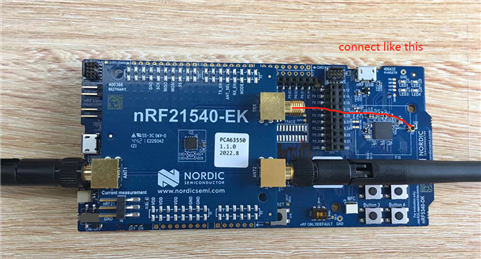

    TRX connect like this?
    Best Regards

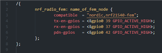

    child_image\hci_rpmsg.overlay
    That means the nRF21540 GPIO mode implementation of FEM is compatible with this device and implements the 3-pin PA/LNA interface. See GPIO mode. To use the SPI interface, see SPI/GPIO mode.

    Only use ANT1;
    There is an optional property to select antenna:
    ant-sel-gpios - GPIO characteristic of the device that controls the ANT_SEL signal of devices that support antenna diversity
    See Optional properties

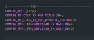

    yoyou said:
    TX power set to maximum 20dBm (Fixed value);
    CONFIG_BT_CTLR_TX_PWR_MINUS_20=y is set to -20 dBm.
    Currently, we don't support run-time switching of TX gain by the application. It needs to be configured in Kconfig, passed to the child image just the way you did it with child_image/hci_rpmsg.conf and it is set by the network core on initialization. The relevant piece of code: https://github.com/nrfconnect/sdk-nrf/blob/v1.9.1/subsys/mpsl/fem/mpsl_fem.c#L284-L295

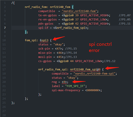

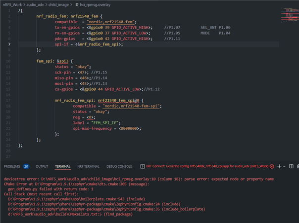

    To put it another way.

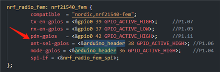

    above, i want only use ANT1 fixed,and not use SPI control (3 pin mode).
    is the SCH(ANT_SEL---GND) and overlay configuration correct?
    child_image\hci_rpmsg.conf

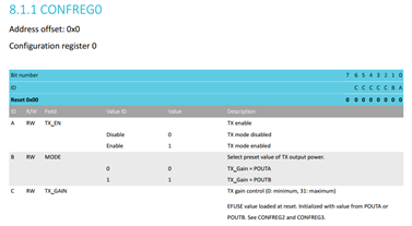

    above, i want to:
    1. TX power set to maximum (Fixed value);
    2. TX power don't need changed dynamically;
    3. RX GAIN set to minimum (Fixed value);
    4. TX GAIN set to maximum (Fixed value);
    is the configuration correct?

    For hardware connecting, see You can refer to our reference design Schematic with single antenna.
    It might need to change name_of_fem_node to nrf21540_fem, so it would look like
          nrf_radio_fem: nrf21540_fem {
             compatible  = "nordic,nrf21540-fem";
             tx-en-gpios = <&gpio0 13 GPIO_ACTIVE_HIGH>;
             rx-en-gpios = <&gpio0 14 GPIO_ACTIVE_HIGH>;
             pdn-gpios   = <&gpio0 15 GPIO_ACTIVE_HIGH>;
    The `CONFIG_MPSL_FEM_*` configuration looks fine, but because the BT_CTLR_TX_PWR_ is not being used by the SDC in the code, to set TX power for Bluetooth, you need to use HCI commands. This is a known issue, see Known issues — nRF Connect SDK 1.9.99 documentation (nordicsemi.com). If you could use nRF21540DK, here is an example in this thread. That might be easier.

    i want to set max power and max GAIN for adv, (all maximum)
    it is also desirable to enable SPI controls,but i write overlay file wrong.
    If possible, please fixed conf and overlay file and upload a complete project,
    it can be used as an official example for many people.

    The team said setting SHIELD variable does that part for the overlay and config. There's no need to set any additional Kconfig options manually. If you're building a BLE-only application (without 802.15.4) then the child image chosen for the network core is going to be hci_rpmsg, so the SHIELD variable should actually be set for that child image:
    west build -b nrf5340dk_nrf5340_cpuapp -- -DSHIELD=nrf21540_ek -Dhci_rpmsg_SHIELD=nrf21540_ek
    The bluetooth would get the FEM TX power. So all standard Bluetooth samples should work as long as you take the sample and enable the EK overlay (-DSHIELD=nrf21540_ek). It doen't need extra setting in the BLE application.

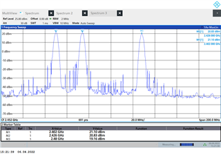

    I use the hci_rpmsg.conf with BLE sample without modification of code
    # FEM
    CONFIG_MPSL_FEM=y
    CONFIG_MPSL_FEM_NRF21540_RX_GAIN_DB=0
    CONFIG_MPSL_FEM_NRF21540_TX_GAIN_DB=20
    CONFIG_BT_CTLR_TX_PWR_DYNAMIC_CONTROL=y
    I get the reslut in the Lab:
    -Amanda
