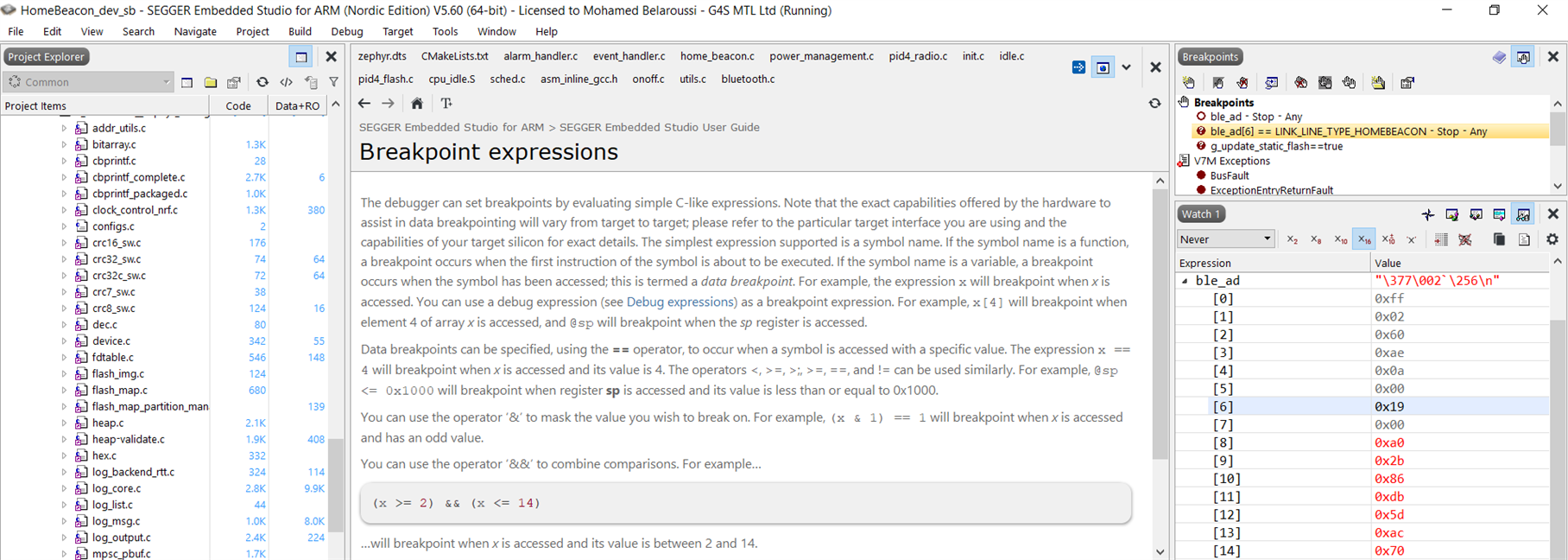

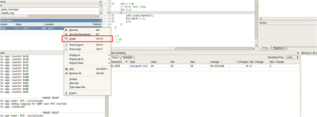

I am trying to set a data breakpoint expression on a global array or global variable  but I don't seem to be able to.
Each time I set a data breakpoint I get a '?' next to the breakpoint. See attached picture.
uint8_t ble_ad[HB_BLE_AD_BUFF_SIZE_MAX].
I am using segger Embedded Studio v5.60 and nRF52833 SoC.
Thank you.
Kind regards
Mohamed

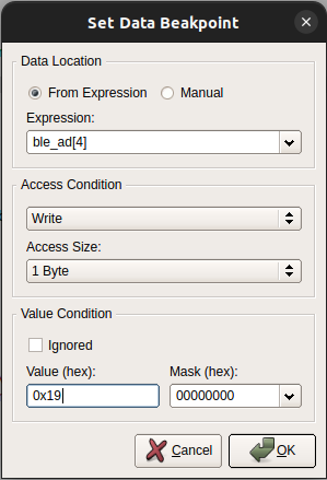

  • Hello Mohamed,
    I created a global array named 'ble_ad' to try and reproduce this here, but it seemed to work for me. In your case, when you start typing your expression, does the variable get displayed up in the suggestion list as shown here:
    Vidar
  • Hi Vidar,
    Thank you for the quick response.

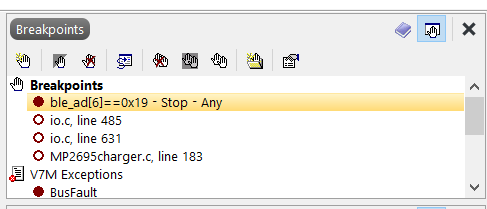

    What you did worked for me too. I ran into problems when I tried to use a data breakpoint expression applied to that variable. I suggest you edit your data breakpoint and try to use the expression I am using ble_ad[4] != 0 or any other C-like expression.
    After restarting SES IDE I can now set the data breakpoint expression without getting the '?' next to it. Very odd!
    However, the program is not breaking as expected. I checked this by setting a breakpoint at the line where ble_ad[6] is assigned the value 0x19 and it does execute this line an breaks.
    ble_ad[6] = LINK_LINE_TYPE_HOMEBEACON;

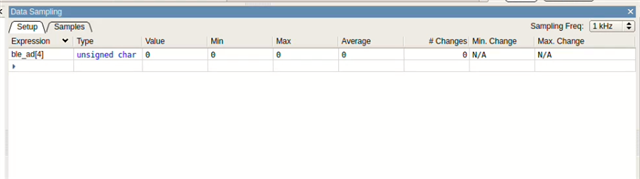

  • Good Morning Vidar,
    An alternative (not as good as a breakpoint) may be to use trace in Ozone and sample the register value periodically. This way you can monitor whether the array element is overwritten or not.
    I am not sure how to do this. Could you please give me an idiot step by step guide ?
    Thank you.
    Kind regards
    Mohamed

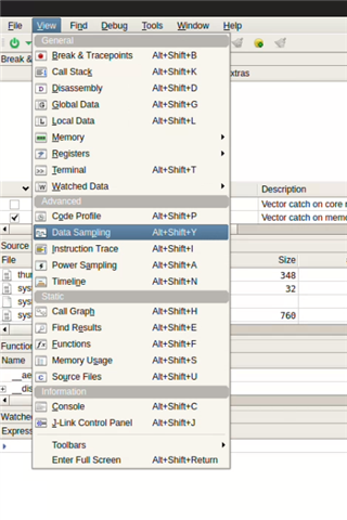

  • Hi Mohamed,
    I am not sure what you have tried so far, but it seems like you have to do is to open the 'Data sampling' view and then input your expression. It is the first time I have used this myself.
    Vidar

  • Hi Mohamed,
    The 'data sampling' feature is used for monitoring a variable over time. The only reason it may not be as good as a data breakpoint in this case is that it will not halt the CPU if an invalid value is written.
