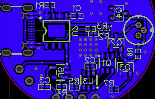

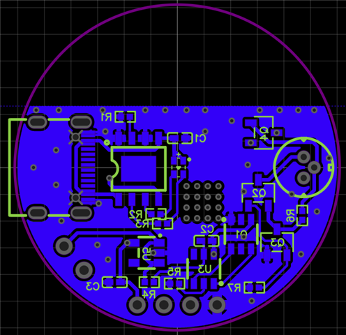

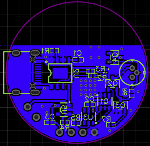

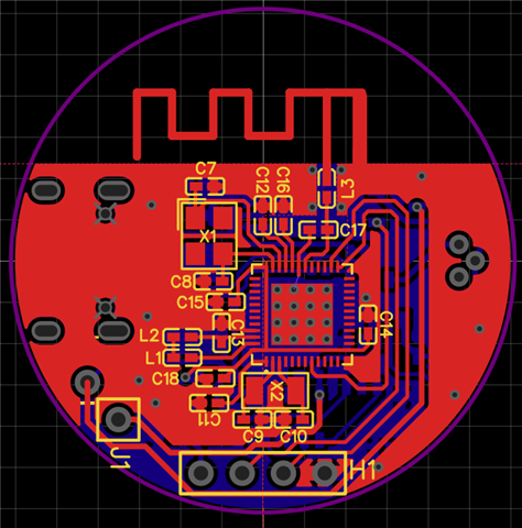

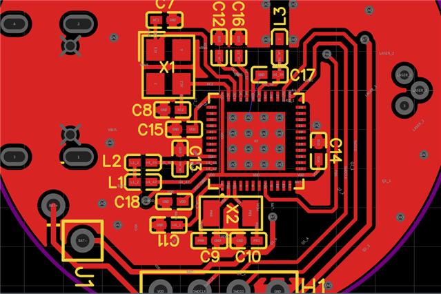

  • I also have zoomed pictures to view the traces with their names.

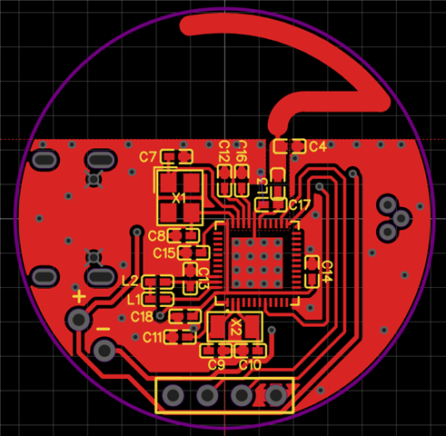

  • Is an simple antenna layout like this going to work ? I found some other projects with the NRF52832 where this setup worked. I don't need long range for Bluetooth, max like 5 meters

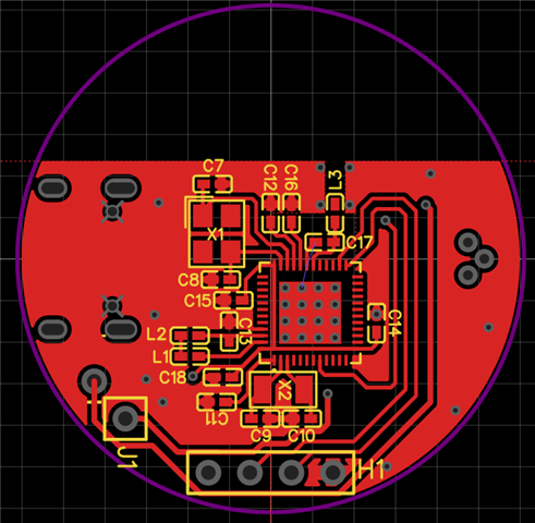

  • This looks better, but there are still a couple of points that needs to change:

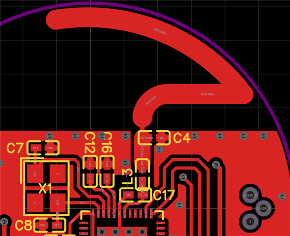

    • No traces can be routed under RF path, these 3 traces must be moved:

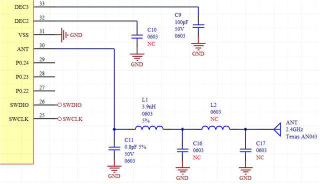

    • A antenna matching network is needed to match the antenna impedance, and tune the resonance frequency. For this type of antenna I recommend using a pi network(shunt-series-shunt). The values of the components must be determined by measuring the antenna impedance and SWR, so as a starting point the shunt components can be NC, and the series component a 0 Ohm resistor.
    Other than this the layout looks good.
    Bendik
  • I change the 3 traces under the RF path, that is fixed now. Can you maybe explain a little bit more about the antenna matching network ? I am really unexperienced about that part.. Or can you give me an example matching my PCB ? I found an example of an pi network, is this what you mean ? How does this setup look on the PCB itself ?
    Isn't it better for me to copy the monopole antenna from the DK board ? Maybe it is an easier solution for this board because i dont need that long range anyway
    Yes, this is what I meant. The nRF52840 dongle uses a Pi network for the antenna matching, here is a snippet from the layout showing how the components are placed:
    The most important part, is that the matching network is placed close to the antenna.
    We have a paper outlining the antenna matching process: https://infocenter.nordicsemi.com/pdf/nwp_017.pdf?cp=18_15,
    Since not all of our customers have the required equipment for tuning the antenna, we offer tuning antenna tuning free of charge for designs using our SoCs. When the prototypes are produced you can create a private ticket requesting tuning. At the same time we will also measure the output from the radio, and tune the radio matching network. This will make sure the harmonic distortion is not causing spurious emissions above the regulatory limits.
    The monopole antenna will still required tuning. They only require one shunt capacitor as the matching network, but the length of the antenna will also be adjusted during tuning. This means that a second revision of the PCB must be made after the antenna have been tuned, with the new antenna length.
