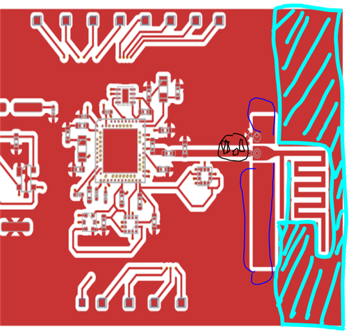

low power wearable electronics.
I have designed single layer pcb for the first time using kiCAD software for  low power (1-5mW) wearable electronics using nRF52840,one accelerometer sensor i.e.BMA400,one recommended antenna(AN91445) and one 2x5 programming port. Please refer to the attached the document. Please suggest any correction and a suitable program/code so that we can test it using ARM Segger Studio.Low power basic Reference.pdfLow power basic1.0.csv
  • Hi  ,
    The cost saving is not worth it in this case. The performance will be terrible and not representative of a two(multi) layered design so it will not be representable of the final product.
    So this is not recommended. Pleas follow the reference layout to achieve good results. Failing to follow the design guidelines can result in a non working device.
    The center pad of the SoC needs to be connected to the rest of the ground for the radio to work as intended.
    Also the antenna you have used is degined to have a ground plane also. So it might not work at all as it is in your current desing.
    https://www.infineon.com/dgdl/Infineon-AN91445_Antenna_Design_and_RF_Layout_Guidelines-ApplicationNotes-v09_00-EN.pdf?fileId=8ac78c8c7cdc391c017d073e054f6227
    Jonathan
  • This is the updated version of Low Power Wearable Electronics.Please check it and suggest corrections....

  • Is there any reason for this, that all critical components should be close to the chip....?
  • Hi  , did you mix up what ticket you replied to? Was this where you intended to update  https://devzone.nordicsemi.com/support/310814 ?
    Yes, it is important to follow the layout recommendations. Deviation from can cause unexpected issues. Like reduced RF performance and it could also effect the devices stability making it more prone to be effected by external EMI.
    Jonathan
  • Please reffer the attached documents........As per your suggestions,I have made changes.....Please check it and suggest corrections.....
    _autosave-tanvi_updated- reference.pdfLow power final.csv
  • In your reference schematic,there will be a resistor R1 which is connected to the VBus.and value of R1 will be 2R2 as per your schematic.....Can you tell me what is the actual value of R1 resistor?
