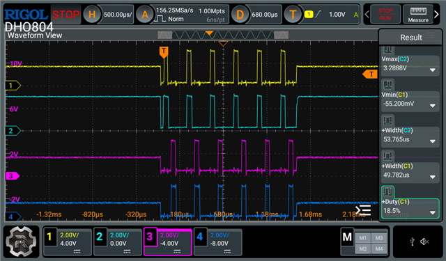

I am checking the GPIO waveforms on an oscilloscope, I would expect to see pulses that are 50us and 40us long. This is mostly what I see, however, every other second or so, I see a jump on the pulse width with a maximum of 190us when it should be 50us.
Pulse width jitter has been a major problem in previous versions of my software, that I drastically reduced by utilising k_busy_wait instead of k_usleep, and by adding the irq_lock. However, the jitter has not disappeared. Based on a sample size of 1000 pulses, the deviation for each of the 50us pulses I am scoping is about 10us, which is a lot higher than I would expect.

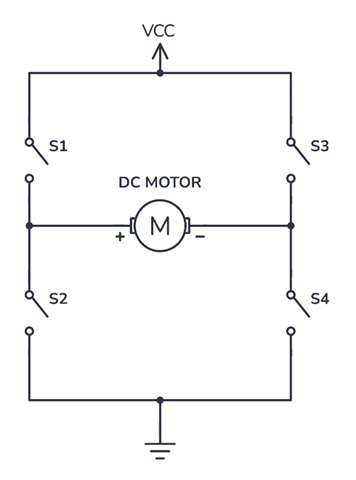

  • The driving circuit is an H-bridge (I've pasted a dummy setup I found online; my circuit does not connect to a motor). I have 4 GPIOs going to the 4 switch inputs on the H-bridge arms. These signals have line buffers to avoid overloading the GPIOs.
    So when I call positive_electrodes(), S1 and S4 turn on. Similarly, when I call ground_electrodes(), S2 and S4 are turned on. I used 50us and 10ms times as examples in the code excerpt but I actually need to configure pulse widths between 50us - 500us delivered at 10Hz - 200Hz at runtime based on user input.

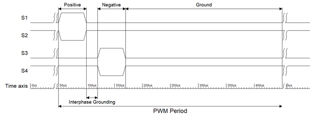

  •  It was about time I looked deeper than what the Zephyr APIs offer and I am thoroughly impressed by how powerful the PWM, PPI, and TIMER peripherals seem to be. I have an idea that I'd like your opinion on.
    Turns out, if I slightly modify my output signal chain to positive -> GND -> negative -> GND, S2 = ~S1 and S4 = ~S3. Since the frequency and duty cycle is the same across all 4 (ignoring dead time for now) with S3 and S4 just being phase shifted by a known amount, I figured I could use my remaining PWM module to get the signals made. But if I understand correctly based on the PWM documentation and this discussion post, triggering TASKS_SEQSTART[n] will start the wave counter for every enabled channel and so I will not be able to use PPI to generate a PWM phase delay for channels within a PWM module, only from one PWM module to the other, correct?
    If that is indeed the case, how about I setup S1 and S2 as 2 channels of the remaining PWM module operating with an up-and-down wave counter and have S3 and S4 as GPIOTE pins? This way I could set the S2 duty cycle to be slightly larger so I get deadtimes on either side of the S1 enable region.
    EVENTS_SEQSTARTED[0] can then be used to start a TIMER that is already configured with the appropriately calculated CC[n] registers such they can trigger the 4 GPIOTE SET and CLR tasks that are required to form the negative phase and transition into the GND phase for the rest of the PWM period.
    The only other issue I can think of is that EVENTS_SEQSTARTED[0] is only raised at the very start of the PWM module being started, but this can be solved by another TIMER that lasts exactly as long as the PWM period to restart the S3/S4 GPIOTE triggering TIMER.
    Would this then in-fact be an exclusively hardware implementation to drive the H-bridge? Of course every time the user changes the pulse width/pulse frequency I should be able to stop the PWM and clear, reset all the timers, and reconfigure PWM and TIMER registers for the new settings.

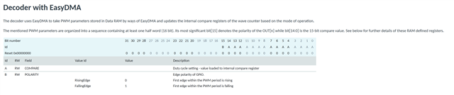

  • Much simpler solution is to simply use all 4 PWM output pins and no GPIOTE would then be required; a true hardware solution. I have some code which does just this, used as a pulse driver for a pump motor. There are two sequences in the PWM peripheral allowing toggling between sequences which allows the user to change pulse width and pulse frequency without stopping or interrupting the pulse train. Usually with a fixed Dead Band ("Interphase Grounding") only the pulse frequency is changed and the pulse widths auto-scale; in some cases the pulse frequency is kept constant and the pulse widths are changed allowing power control (think LED dimming). Both are possible with the PWM peripheral. Conceptually using 2 pins with external hardware looks like this (one table for each sequence):
    //  Full or Half H-Bridge PWM - Variable pulsewidth/pulse frequency step lengths
    //   +----------------------------------> COMP0 OUT[0] Compare 0 - PIN_PWM_S1S4
    //   |         +------------------------> COMP1 OUT[1] Compare 1 - PIN_PWM_S2S3
    //   |         |         +--------------> COMP2 OUT[2] Compare 2 - PIN_SUPPLY_EN (3 volt power source)
    //   |         |         |               (COMP3 OUT[3] Compare 3 not used)
    // | Compare | Compare | Compare | Top     | Cycle N
    // | Compare | Compare | Compare | Top     | Cycle N+1
    // | Compare | Compare | Compare | Top     | Cycle N+2
    //                                 +----> COUNTERTOP Cycle Period 4 steps, 1MHz clocks. Range 3-32767
    //                                       (LOOP       Repeat Count, number of periods - no repeats)
    Using 4 pins requires other than Wave Mode or requires two PWM peripherals in synch. I'll dig out my code and post later today.
  • If I understand correctly, the snippet you posted requires tying S1/S4 on one pin, and S2/S3 on another?
    The GND phases I refer to above aren't dead times, those are specifically when both low side switches (S2/S4) are turned on so that the positive and negative terminals of the output are both pulled to ground. This is a necessary part of the output terminal behaviour. Do you still think this could be solved by one PWM module?
