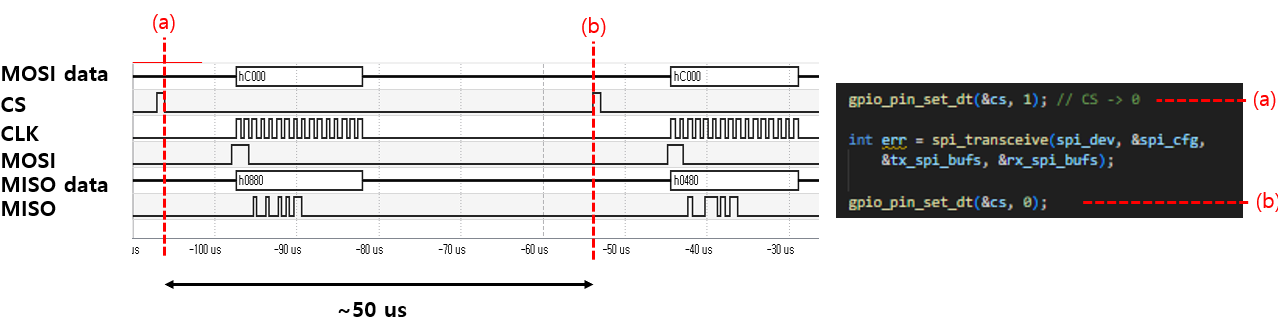

I am trying to exchange data with an external slave sensor via SPIM communication using the nRF5340DK.
I am currently facing two main issues:
1.The spi_transceive() function takes too long to execute.
This is significantly reducing the effective data transfer rate.
I have also reviewed a Q&A from someone who pointed out a similar delay with spi_transceive().
( Time gap between each spi_transceive )
However, the solution suggested in that Q&A, which involved modifying spi configuration in the main.c, doesn't seem to be applicable to the nRF5340 as it resulted in an error

In main.c, when I configure the SPI structure, I set the frequency to 1MHz.
I have confirmed with an oscilloscope that the actual clock frequency is indeed 1MHz.

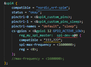

    Have you tried letting Zephyr automatically toggle the CS pin automatically, using spi_tranceive_dt? Does that make any difference?
    I have already tried using spi_transceive_dt(), but I encountered an error when calling SPI_DT_SPEC_GET. As a result, I am using a struct spi_config instead.
    My problem is almost similar with this question: not able to get spi device tree specification using SPI_DT_SPEC_GET
    Purpose of using spi_transceive_dt(), I use SPI_DT_SPEC_GET but the error returns:
    identifier "__device_dts_ord_DT_N_S_soc_S_peripheral_40000000_S_spi_a000_BUS_ORD" is undefined
    This suggests the bus node is undefined. I tried to define it in my overlay file by referencing a lesson on the nRF5340's SPI.
    https://academy.nordicsemi.com/courses/nrf-connect-sdk-intermediate/lessons/lesson-5-serial-peripheral-interface-spi/topic/zephyr-spi-api/
    Even though I used the similar syntax as in the lesson's overlay file, I believe I can't properly define the bus node because I don't know the compatible string for my slave sensor (RHD2132, used for recording neural signals).
    Since there is no built-in Zephyr driver for the RHD2132, I need to write a custom one. However, creating the device tree bindings for it is proving to be complex. This is why I've fallen back to using spi_transceive() for now.

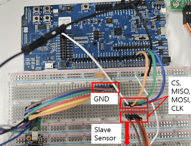

    How is the sensor connected? Is it possible to shorten the wires or solder the sensor directly onto the DK? Would you be able to share a photo of your setup?
     I have attached my current configuration for review:
    The wires are currently long for testing, but the final design will be implemented on a PCB. We also plan to use LVDS in the future to improve signal integrity.
    Thanks to the help from Turbo J, there has been a significant improvement in the signal quality.

  • To increase the system clock, should I add the following line to prj.conf?
    CONFIG_SYS_CLOCK_HW_CYCLES_PER_SEC=128000000
    It seems almost impossible to reduce the transaction. The sensor I am using is a device for measuring neural signals (RHD2132), and the transaction is directly related to the neural signal's sampling rate, so it needs to occur as frequently as possible.
    (Currently, the execution time for spi_transceive() is 50µs, which is much longer than I want. I am hoping for the spi_transceive() execution time to be at most 5µs, considering a 16-bit transfer at 16MHz should take 1µs.)

    You do not need a full Zephyr driver for your sensor to use the automatic CS handling. You only need a device tree node for your SPI slave with a unique compatible string (it can be vendor-specific, e.g., "myvendor,rhd2132")
    I will try to get back to you with more detailed instructions tomorrow. Some answers might be found in the SPI-lesson you referred to.

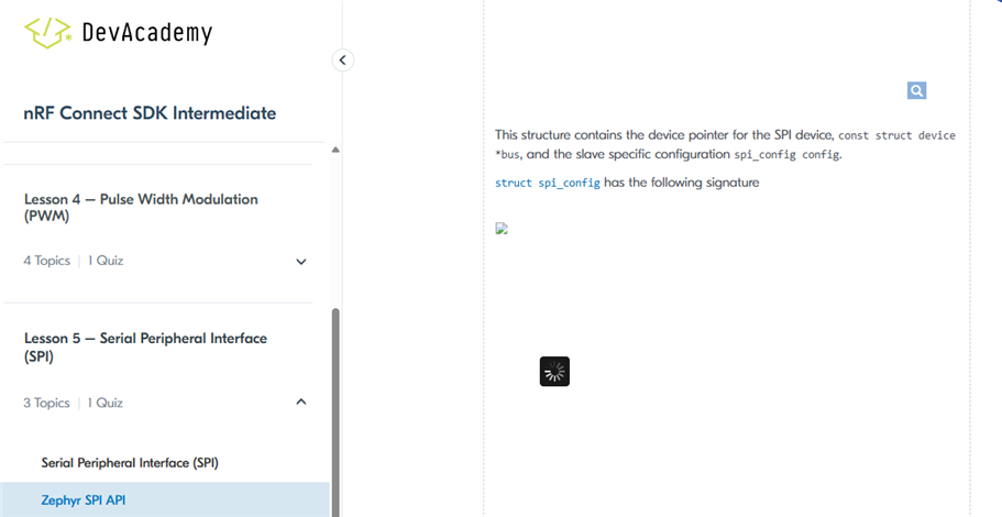

    In fact, I was referencing the example code from the SPI-lesson I mentioned.
    lesson_codes
    Even though I referred to the overlay file's SPI node and the spi_struct in the main function from the nRF5340 example code, I am still unable to read a specific node from the device tree.
    (For purpose of practice, I use bosch,bme280)
    identifier "__device_dts_ord_DT_N_NODELABEL_bme280_BUS_ORD" is undefined
    From my experience, this issue appears to occur when I try to load a node that I have defined myself, rather than a built-in one. (For that reason, I am also using a pin originally registered as a button for the CS pin that will be controlled by GPIO.)
    I look forward to your assistance.
    gwan0624
    P.S. There is an error on the community's lesson page. Some images are not displaying.
  • You are missing CONFIG_SENSORS=y, that should make the BME stuff work.
