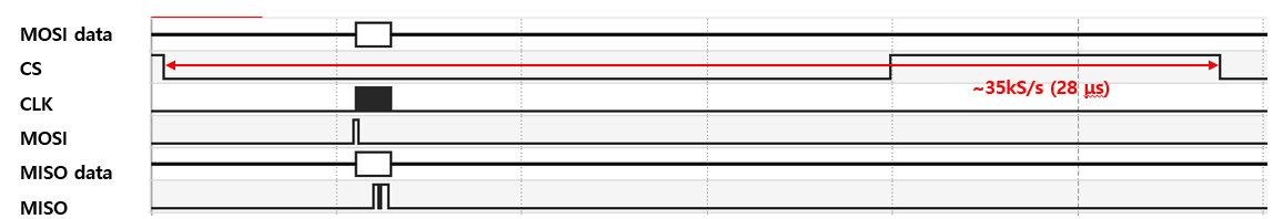

I am trying to exchange data with an external slave sensor via SPIM communication using the nRF5340DK.
I am currently facing two main issues:
1.The spi_transceive() function takes too long to execute.
This is significantly reducing the effective data transfer rate.
I have also reviewed a Q&A from someone who pointed out a similar delay with spi_transceive().
Time gap between each spi_transceive )
However, the solution suggested in that Q&A, which involved modifying spi configuration in the main.c, doesn't seem to be applicable to the nRF5340 as it resulted in an error
To clearly explain my situation, I have attached my main.c, overlay, and configuration files.

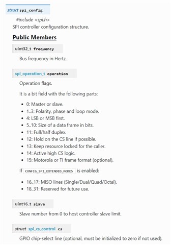

static struct spi_config spi_cfg = {
    .frequency = 1000000,           // SPI frequency.
    .operation = SPI_OP_MODE_MASTER | SPI_WORD_SET(8) | SPI_TRANSFER_MSB, // SPI Mode 0
    .slave = 0,                     // Master mode
    .cs = NULL,
    //.cs = &spi_cs,                // Manage CS pin with cs-gpios in Devicetree

In main.c, when I configure the SPI structure, I set the frequency to 1MHz.
I have confirmed with an oscilloscope that the actual clock frequency is indeed 1MHz.
Also, I'm controlling the CS pin directly via GPIO
2. Although the nRF5340 specifications state that it supports SPI frequencies up to 8MHz (and even up to 32MHz for spi4),
the quality of the Clock (CLK) signal degrades significantly at frequencies higher than 4MHz.
Thank you.

    I have already tried using spi_transceive_dt(), but I encountered an error when calling SPI_DT_SPEC_GET. As a result, I am using a struct spi_config instead.
    However, as you initially suggested, the problem might be that I am not controlling the SPI properly through the device tree. (Currently, I am unable to load the custom pins from the overlay file using DEVICE_DT_GET, so I am using the built-in LED or Button instead). Therefore, I plan to re-examine the device tree configuration.
    Additionally, the following post recommends using the IFTIMING.CSNDUR register, which I also plan to try: How to reduce spi chipselect to sclk delay

    Currently, I have succeeded in controlling the CS pin through the Devicetree instead of the existing GPIO-based CS pin control. (Simply performing a pristine build enabled the use of the existing Devicetree's SPI_DT_SPEC_GET related functions.)
    However, the long delay between the CS pin's ON/OFF and the CLK signal was not resolved even with Devicetree-based control.
    However, I found a post that dramatically reduced this delay when using the lower-level DPPI instead of the SPI Driver!
    NRF5340 SPIM turnaround time
    Here, there is almost no delay between the CLK and the CS pin! This was what I wanted.
