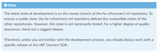

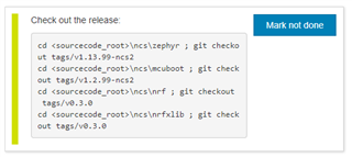

  • Hi Bjørn, thanks for your prompt response. Please see the screen shot below - similar to others'. I tried a couple of GNU versions as well. I did setup as indicated in the guide. Thanks.
  • This applies to all three of you. I find it weird that you all receive so little logging information. Normally, you can easily see where the error lies. If you have recently downloaded the Nordic Connect SDK (around the12.2.2019), I believe the cause of this may be that we are now using west, Zephyr's meta-tool. There is more documentation here that may be helpful. Could you try to download west, update to the newest repositories & then try opening the SES examples again? Hopefully, you will then receive more logging information that can help you debug the issue.
