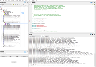

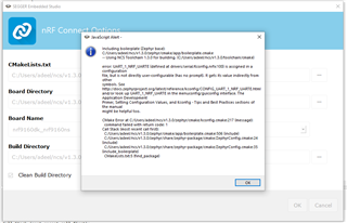

When I try to build my application, I get a Kconfig error regarding the CONFIG_UART_1_NRF_UARTE=y. Could you help me understand what more could be required to change for it to work for UART_0.
Adeel.
  • In NCS v1.3.0 the configurations CONFIG_UART_<x>_NRF_UARTE are not directly user-configurable and you can not set them in the prj.conf file. These configurations will get their value from the Device Tree. E.g. if you have enabled uart1 in the overlay file (status="okay"), the configuration UART_1_NRF_UARTE will get enabled here.
    So in short, just removed CONFIG_UART_1_NRF_UARTE from prj.conf.

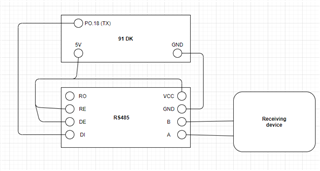

  • Hi Simon,
    I did that as well. I tried to set both the pins (RE-DE) to high before transmission so that DE is enabled and RE is disabled. Then after the transmission, I tried to give a bit of a delay and then cleared both the pins to low so that DE is disabled and RE gets enabled.
    I dont have a logic analyzer right now but will try to manage it.
    Are there any examples of RS485 communication for nRF9160DK that I could refer to for more info.
    Adeel.

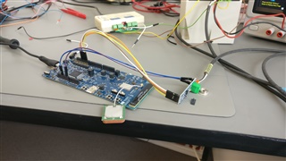

    Could you look at the logic to see if this is the right way to enable / disable the DE/RE pins. The hardware connections are as per the overlay file.
    The loopback works when I only connect Tx to Rx directly, so I guess the issue is only with the DE/RE pins. The loopback data is:
    I think I am close but just need some advice in enabling / disabling DE/RE pins in the code. Thanks for the help Slight smile.
    Adeel.

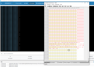

    Still, I don't see the data out on my analyzer. I have a serial interface analyzer where I view the string. I tried with Arduino and that worked just by a transmit signal.
    So, I am unsure as to what could be the causes for it. I can see the loopback data in this example as well when I connect my Tx to Rx.
    (1). I have the correct overlay files both in spm (nrf9160dk_nrf9160) as well as in my folder (nrf9160dk_nrf9160ns)
    &uart2 {
    	status = "okay";
    	current-speed = <9600>;
    	tx-pin = <10>;
    	rx-pin = <11>;
    	rts-pin = <12>;
    	cts-pin = <13>;
    	hw-flow-control;
    &uart1 {
    	status = "disabled";
    I have also changed the configuration in the nrf9160dk_nrf9160_common.dts file in : C:\Users\adeel\ncs\v1.3.0\zephyr\boards\arm\nrf9160dk_nrf9160.
    My prj config file is :
    CONFIG_UART_ASYNC_API=y
    CONFIG_TRUSTED_EXECUTION_NONSECURE=y
    CONFIG_MAIN_STACK_SIZE=4096
    CONFIG_UART_2_NRF_FLOW_CONTROL=y
    I am unsure of what could be the issue ? The configuration or the code.
    I just want to transmit the string set in uart_fifo_fill() function in my code to check the UART connection.
    Adeel.

    Not really. I could not figure out the exact trouble with it. The loopback works with Tx to Rx. So I assume that the string is atleast reaching the Tx.
    I followed this post and got a simple example : https://devzone.nordicsemi.com/f/nordic-q-a/47218/continuously-package-send-on-uart
    The string transmission to an outside serial interface is not happening. I wonder what could be the cause.
    When I just take out and put back my Tx pin on the board, I see random data on the serial analyser. I am sure the RS485 configuration is correct because for now, I just want to transmit the string. The DE is kept high for that and RE high as well (Negative logic). Any insights would be helpful.
    I hope there is no mistake in my UART config atleast.
    Adeel.
