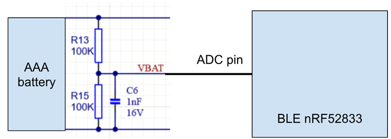

We're reading BAT level by reading data from ADC pin and the setup diagram is shown below.

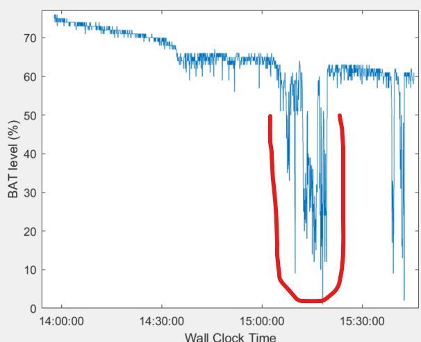

We tested our device at hospital, and we observed significant fluctuation highlighted in red regarding its BAT level. For example, it went from 65% to 20%, then jumped to 60% again.

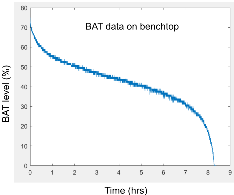

We then took the device and battery back to the office and tried to reproduce the issue on benchtop. However, we couldn't reproduce it. In contrast, the following is what we got, and it worked as expected.
Our hypothesis is that it could be due to the impedance mismatch between ADC input pin and the output of voltage divider. However, based on our calculation, the input impedance of the voltage divider is equivalent to R13//R15 (50kOhm) while the input impedance of ADC pin is more than 1MOhm. This would not cause the impedance mismatch.

    Could you please elaborate what you did in the bench test? I notice that the discharge curve in the field test isn't similar to that in the bench test, assuming that the drain is constant in both scenarios.
    Is it possible that the device underwent any special mode, or was put under abnormal environmental condition during the time with the measurement dip?
    For example, extreme EM noises requiring multiple retries, keeping the radio on for longer, increasing the current draw.
    Is this observed multiple times or just once, and with one particular unit, or multiple units?
    I used exact hardware device and battery used in hospital. I basically turned the device on, connected to our mobile application, then let it run till the battery is fully depleted. I left the device on my desk, which is normal working environment in the office.
    Side note: The first discharge curve was only 1.5 hr long measurement while the second one conducted on bench test was 8 hr long.
    It was running under normal mode. For environmental condition at hospital, it has many medical equipment and there is presence of 2.4 GHz frequency component emitted by this equipment. In other words, it is pretty noisy, and we observed several BLE disconnects due to that before.
    However, for this case I did check the RSSI values recorded in our application. It looked normal.
    It happened for us twice in different hospitals. For another case, we put a branch new battery, the HW device showed low BAT right away and BLE disconnect happened after a couple minutes.
  • We used 1 AAA battery (1.5V) and a boost-buck converter to have the voltage of 3V to power the device. The average life span of battery is about 11.5 hrs.
  • There are so many tests (200 +) done before without any issue with the discharge BAT curve. It recently happened, so I'm very confused.
    Btw, I developed this based on the way to measure BAT level as following:
  • Several issues here:
    • the resistors are not actually required as the  AAA battery voltage is always less than VDD so can be measured directly.
    • the battery will phantom power the ADC pin before the regulator first starts up and supplies VDD; this can create reset problems
    • a series resistor of  high value to the ADC pin can reduce the phantom power risk but will not eliminate the phantom power; most notably on a battery change
    • battery percentage measurement is really only reliable with a known load and temperature
    • shortened battery life is nearly always caused by some unexpected scenario leading to unexpected wakeups (no sleep) or leaving peripherals on when they should be off
    • a low-Iq boost is preferable to a buck-boost as the battery voltage will never be high enough to require buck mode - the regulator will always be in boost mode to meet the minimum nRF52 VDD (say 1.7V)
    Worth searching the devzone for "phantom power" and "back-drive" for more discussions.

  • Summary: "We tested our device at hospital" - result battery issues; tested on bench, no battery issues
    Environment: Hospital has high density WiFi and BLE devices all competing for bandwidth; on the bench not so
    Consequence: Hospital continuous advertising attempting to connect initially or reconnect on a lost connection; bench probably only require a single advert on start or subsequent link loss to re-establish connection
    Algorithm: Sensible BLE devices implement a gradual backoff on advertising, such that if a connection is not established within (say) 2 seconds the advertising rate is reduced; perhaps from 20 or 50 times per second to (say) 2 times per second. Silly BLE devices continue to hammer out advertising packets at a high rate even when it is clear a connection is taking ages to re-establish, and this drains the battery quickly. A low or drained battery will exhibit distorted capacity measurements.
    The test: on the bench ensure there are no devices which will connect with the device; observe battery profile to see if similar to hospital site.
    The fix: (Should this indeed be the case) Implement a gradual advertising backoff algorithm

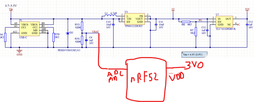

    The following is my power circuit
    Is that really a potential problem here? I'll measure the voltage going into ADC pin and VDD to see which one comes first. In the case ADC pin comes first, will a higher resistor value in R13 help mitigate this issue? Or any other ways to improve it with the current setup?
    Reading your answers in some posts, my understanding is that having TX pin or ADC pin in my case high while the nRF52 is not being powered on potentially causes some issues for nRF52 reset. However, I'm still unsure the root cause for my issue with sudden significant fluctuation BAT level. Is that because of phantom power that leads to some unexpected nRF52 working behavior?

  • The startup time of the TPS61222 DC-DC would be (say) 3mSec and the startup time of the TLV74330 would be (say) 1mSec so perhaps 4mSec in all. Any connection to a port pin of a voltage prior to that 4mSec is a design flaw and a potential issue most likely with incorrect reset behaviour. Will it damage the nRF52? No. Increasing R13 reduces the risk but does not eliminate it; preferable to simply not enable the connection to the pin until 3V is stable, perhaps with a FET or NO (Normally Open) analogue switch; benefits of this approach allows removal of the two current drain resistors across the battery.
    With a 1.5V battery it is a slightly unusual design choice to boost 1.5V or less to 5V with a DC-DC and then reduce the 5V to 3V with an LDO as power efficiency is reduced. Alternatives are to simply use two DC-DC and no LDO, preferably with synchronous DC-DC operation. 3V for the nRF52 is also slightly unusual these days unless there is some attached component that insists on such a high voltage. 1.8V would be preferable as long as no LDO is used. If LEDs etc have to be driven then use a separate regulator with level switchers just for those components, unless of course battery life is unimportant.
    Regarding the extreme noise, I would hazard a guess that there is some daisy-chain interaction with DC-DC, LDO and nRF52 where the DC-DC requires periodic large current bursts when the battery voltage is low towards end-of-life and is unable to provide such high current bursts. The alternative is a software/hardware bug on the nRF52 with the % calculation or voltage measurement or sleep handling.

  •     Thanks for your insights! My initial concern was the abnormal battery discharge curve observed in a noisy environment. However, you guys pointed out flaws in the power design for this device as well as the risk of increasing power consumption due to noisy environment. I really appreciate it!
    One point I'm still unclear on is the significant fluctuation in battery level. While I agree the battery life may be shorter than benchtop tests suggest, the root cause of such fluctuation remains unexplained. Thanks, Tai!
    Update: I reviewed both the data and the video recorded during the period of significant battery level fluctuation. If there had been data loss or retransmission attempts, I would expect to see some lag in the video—but I didn’t observe any.
